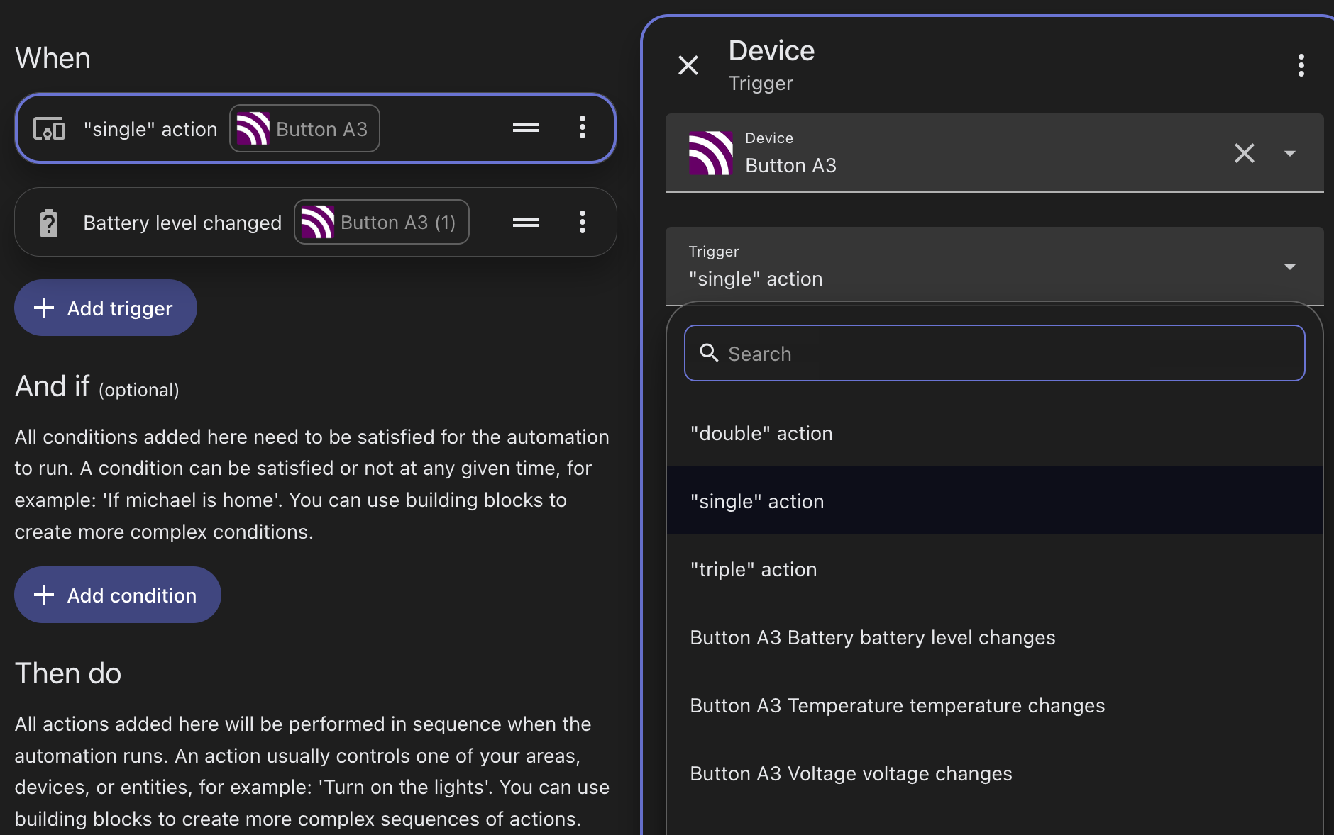

I can manually input the triggers in yaml as action ‘single’ for various buttons from zigbee2mqtt but they never show in the GUI as options.
You’ll need to elaborate. Are you talking about button entities, or devices that are buttons?
When looking for triggers in the automation GUI, the only options it expose are battery triggers. Zigbee2mqtt is fully aware of the ‘action’ exposure and it works if I manually enter it into the automation yaml first, I can then choose from the list of ‘actions’ and they work as expected. But if I don’t put it in the yaml ‘Action’ is impossible to select as a trigger.

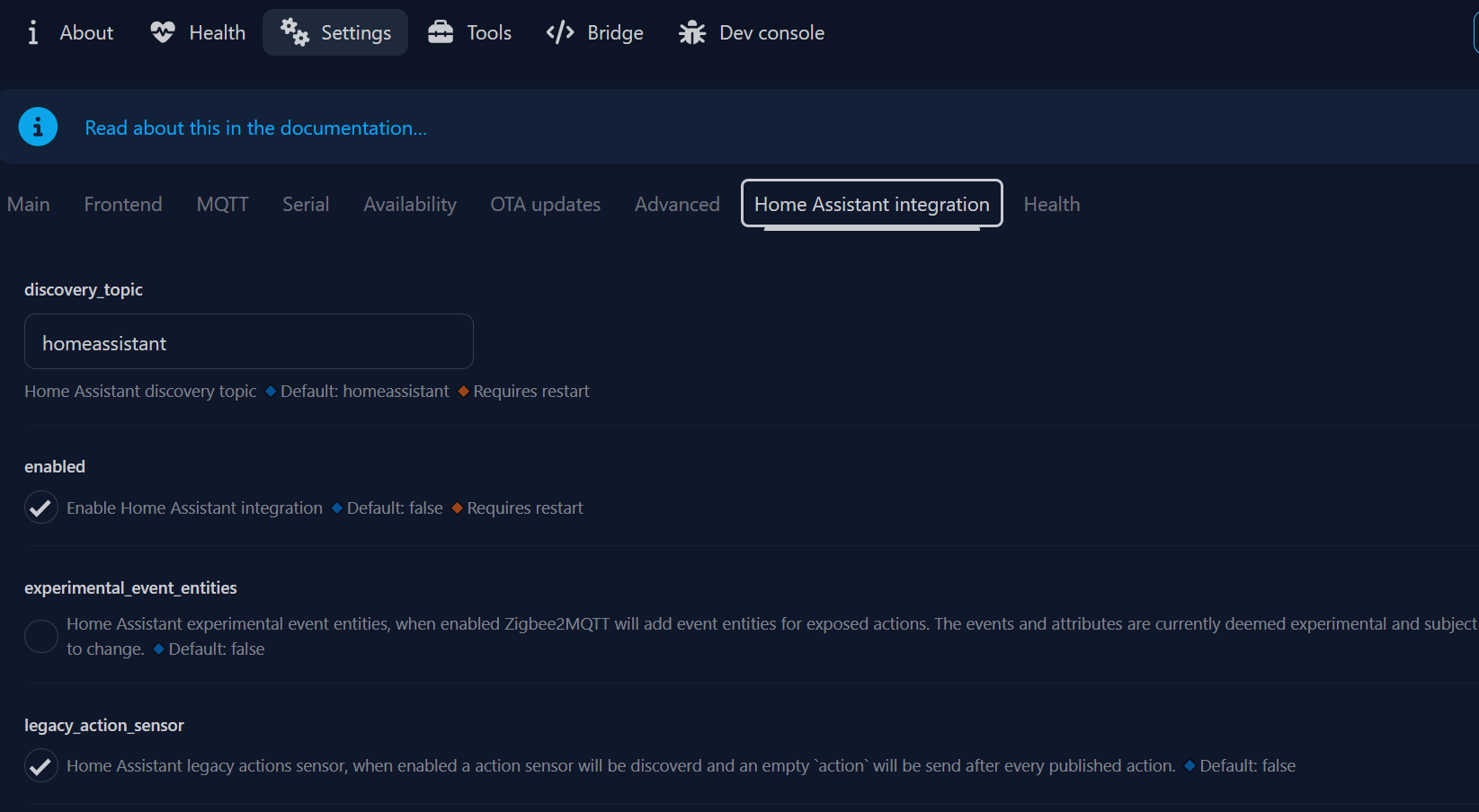

Those are legacy device triggers that work off events. The new triggers work off event entities, you likely need to enable those on the Z2M side as they are not the default option.
Wait - how do I do the enable thing on the z2m side? or what does it called? I was poking around in z2m but don’t know where to do this.
Or is there an explainer I can read up?
here ya go
Super! Thanks.
I gather this is what I would need to do, if I want to do event entities, yes?
Thanks again.
Yep, and restart Z2M
