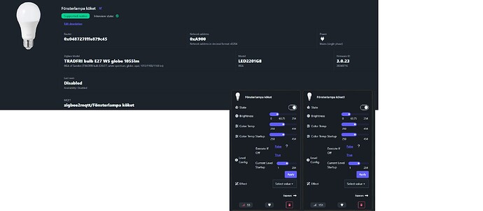

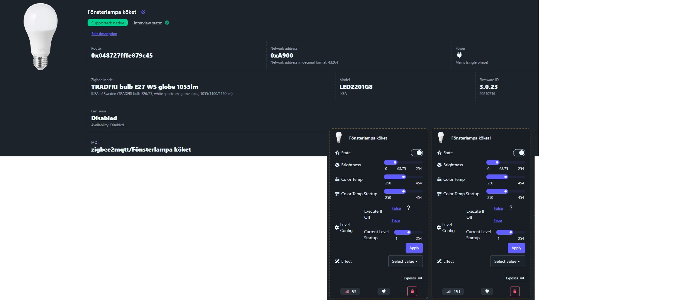

Here is one of the bulbs in Zigbee2MQTT showing details and then the dashbord…

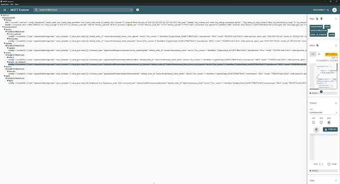

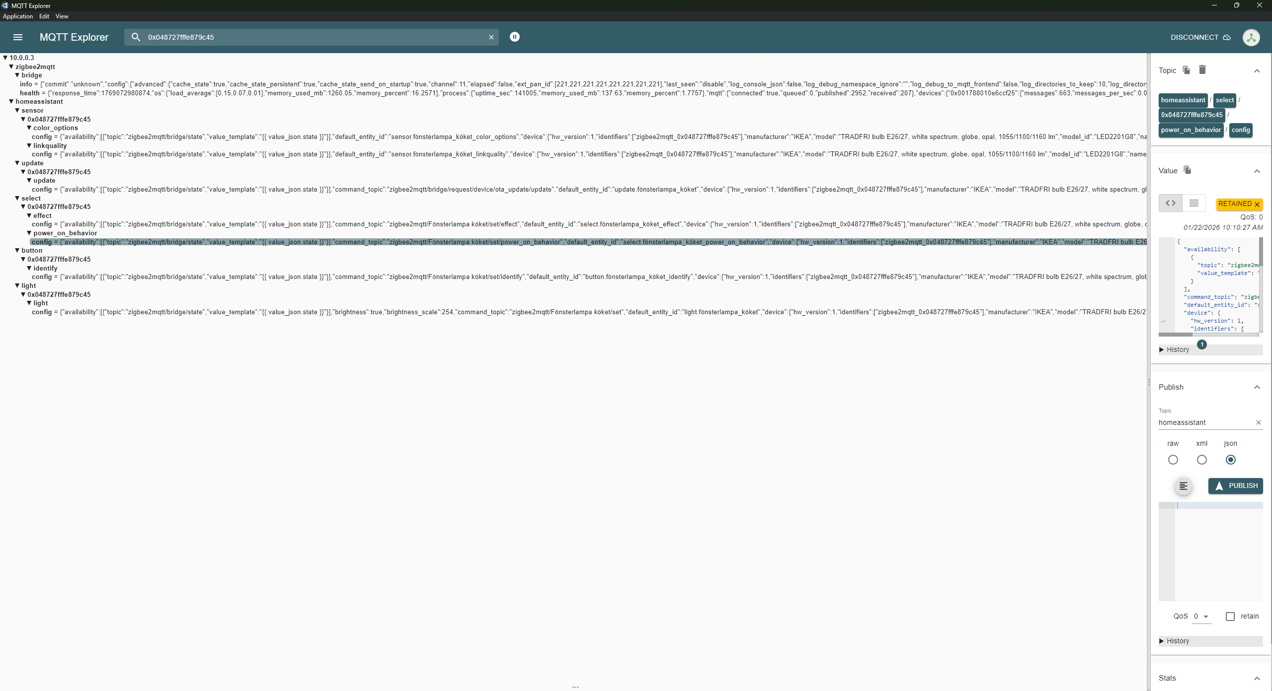

Here is everything in mqtt explorer. I got no experience with how the layout should be. See anything wrong?

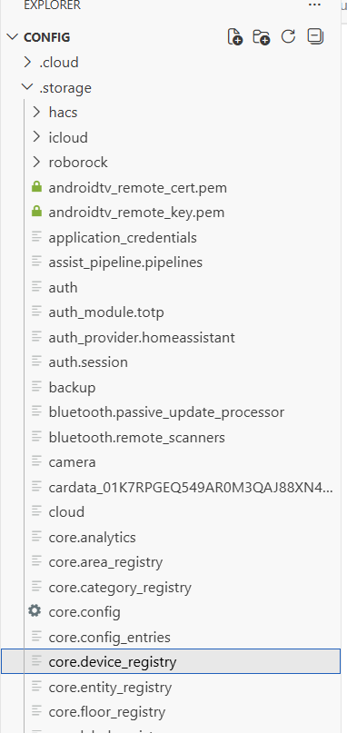

Try looking in the core device registry like I pasted in the previous post. This is a file on HA itself (not MQTT) under the hidden folder called .storage. You can access it with the Studio Code addon for HA for example.

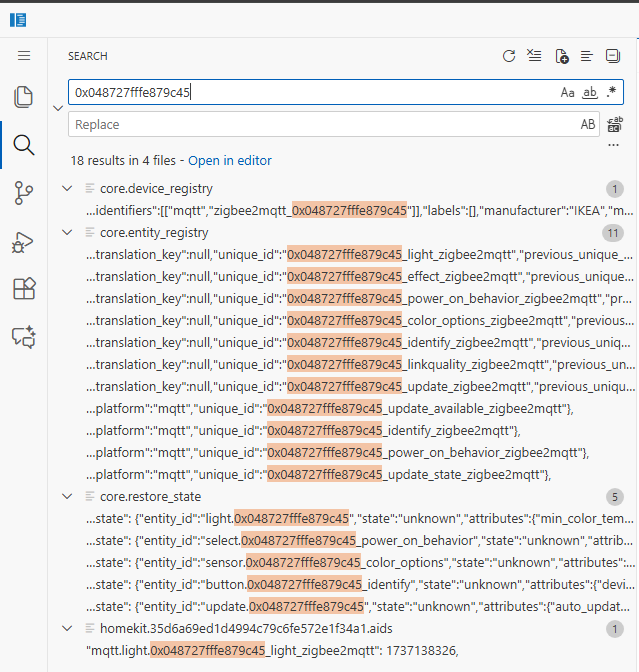

Here are all the entrys in the .storage folder with one of the lights.
This is reporting the device through Z2M. Can you find the device in the registry when it’s not paired through Z2M? Try removing it from Z2M and check if you see it.
