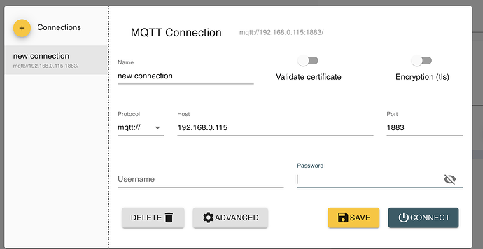

Apparently not. I installed MQTT explorer and get these errors

when trying to connect:

Create a MQTT user with password in HA, then add that user to the Zigbee2MQTT configuration.
