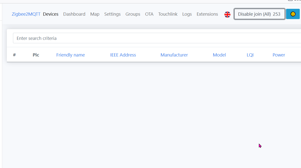

got myself the sonoff zigbee 3 usb dongle plus from amazon. i have not flashed any firmware. i just plugged into my hassOS and everything seems to be fine as seen here in the log:
but Z2M refuses to see any of my zig devices…

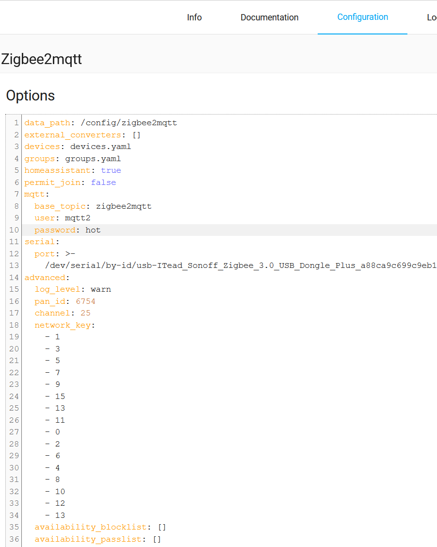

in my config, the only thing i changed was the network key, i swapped some of the numbers around. and the zig channel is 25, instead of 11.
You need to actively re-pair all your Zigbee devices. Did you do this?
(They will not show up on your new Zigbee network even if they worked before without re-pairing to the new Coordinator.)
