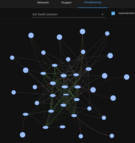

Z2m now has this built in.
Oh, yeah, thx.

No need, it is now built into the zigbee2mqtt UI.
