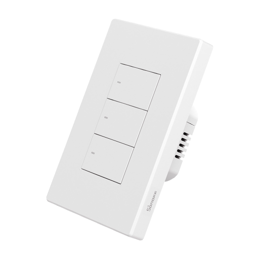

After fighting with it for too long, getting in trouble with the wife, giving up, and finding a similar blueprint for another device, This is a blueprint for the Sonoff 3-button Scene Switch (Created 04/03/2025)
Only supports single presses for each button (switch only reports “toggle_l<1|2|3>”). Any channel that this blueprint will be used on needs to be in detach mode. I assume this should work with the 1 and 2-channel models, also with mixed channels in detach mode vs. not, but haven’t tried yet.
