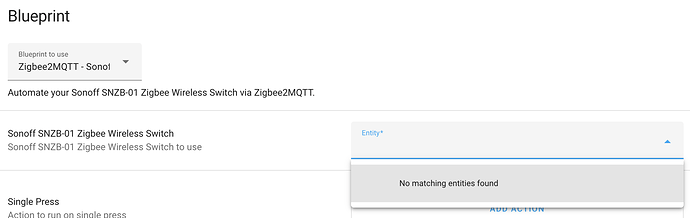

Hi, I have installed this blueprint, but, although my device is enabled, I cannot select it in the blueprint device. Is there something I must do with mqtt??
I got this device info:
Zigbee info
IEEE: 00:12:4b:00:24:ce:5e:16
Nwk: 0xc426
Device Type: EndDevice
LQI: 27
RSSI: Unknown
Last Seen: 2022-05-28T20:20:34
Power Source: Battery or Unknown
Quirk: zhaquirks.sonoff.button.SonoffButton
