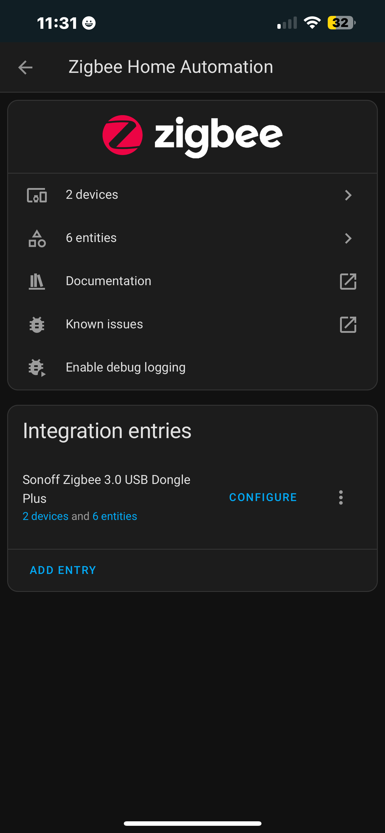

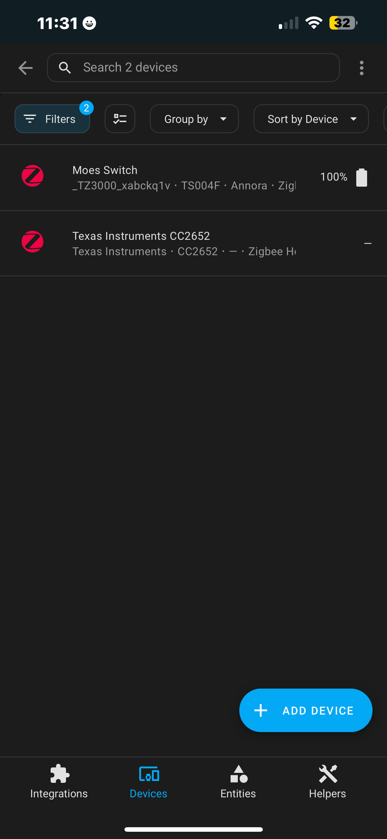

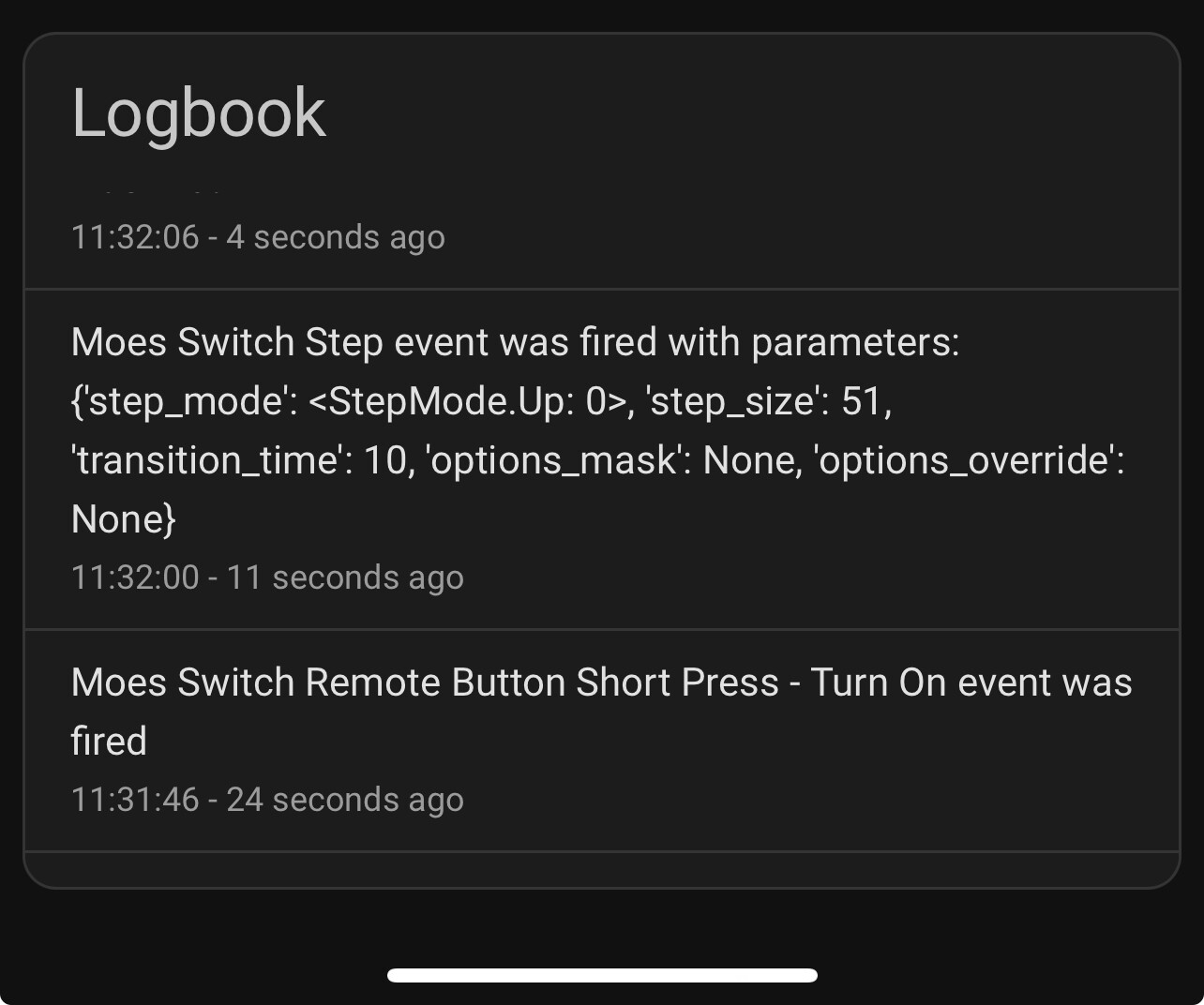

Hi all, I’m pretty new to HA but most of the basics set up. Trying to get my Moes 4 button device working for weeks now with no avail. I’ve tried multiple blueprints and reinstalling the device and can’t seem to work it out. I’m probably missing something simple that many here would know. Model no: ESW-0ZAA-EU.
I’m also wondering if it’s my Sonoff Zigbee Dongle not having installed the device correctly as it’s been giving me trouble and breaking suddenly.
I’ve imported the blueprint above and picked up my device added the devices and actions but not working. The log shows that the 1st and 3rd buttons respond for on and off and the other 2 get the description shown. Apologies if this is quite basic, it’s just been getting on my nerves for weeks and I’m really wanting to improve my home assistant and learn over time to make it my central hub.
