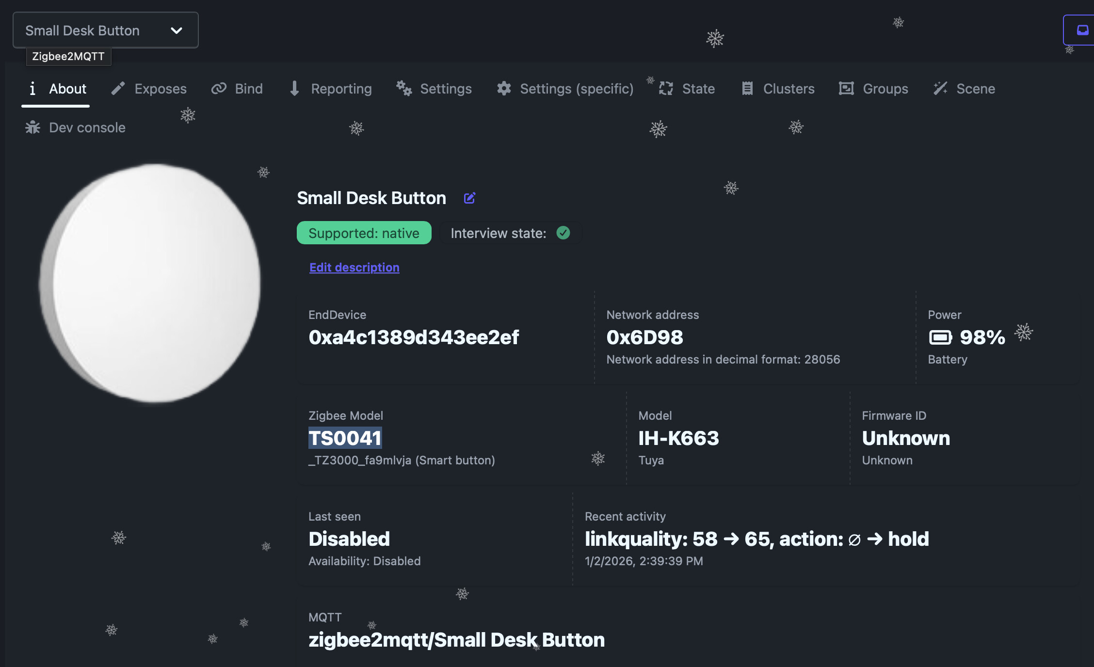

This works great for me, except the long press / hold. I see the long press getting accepted in MQTT so I know I’m doing that correctly (and it gets logged). No matter what action I put for hold / long press in this scene switch doesn’t happen though. single and double press work fine. any ideas?
I think long press did not work, because it is for the pairing mode.
