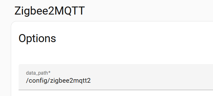

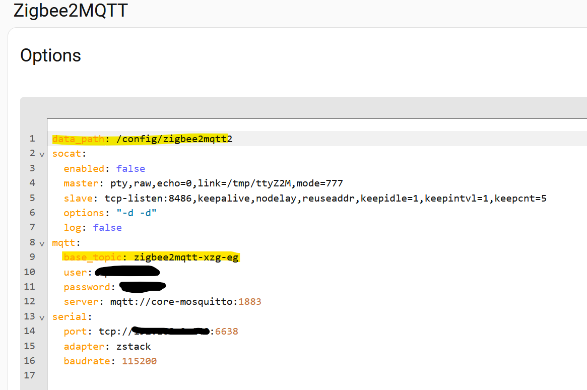

Apparently everything is working now. I noticed not only the IEEE number were the same but even the config folder had the same directory. Now that I made sure those settings are not the same, there is no conflict anymore.
I did not only change the path:
but also the base-topic in the editor:
You are absolutely right. I did the same. The problem was that, since the config folder had the same address on both instances I could only see one configuration.yaml. and then I could not change some of these settings.
I had to make sure the folder addresses were different on order to do that!
Now it works like a charm. I still have to re set the devices on the other instace of Z2M but I think it will work normally.
