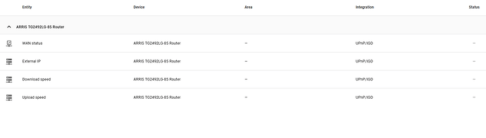

I’ve created an integration that should work with this Ziggo Connectbox: Arris TG2492LG - Home Assistant
this worked nice ly i get my arris
but how can i see what devices are connected to it…
