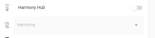

Question from a newbee. On the info page of the device, I get to see the option to select a channel. How would I be able to add this to the dashboard card? I currently only added the device as mediaplayer. I cannot find the entity to select this.
With Harmony Hub I can select (currently disabled)
Welcome @Ferry_Spaan!
I think there’s only one way to do this:
select:
  name: Ziggo next mini source
  unique_id: "abe13cd5-52d0-4a8d-a833-1498fbf7127a" # replace with your own unique id
  state: "{{ state_attr('media_player.ziggo_next_mini', 'channel') }}"
  options: "{{ state_attr('media_player.ziggo_next_mini', 'source_list') }}"
  select_option:
    - service: media_player.select_source
        source: "{{ option }}"
        entity_id: media_player.ziggo_next_mini
