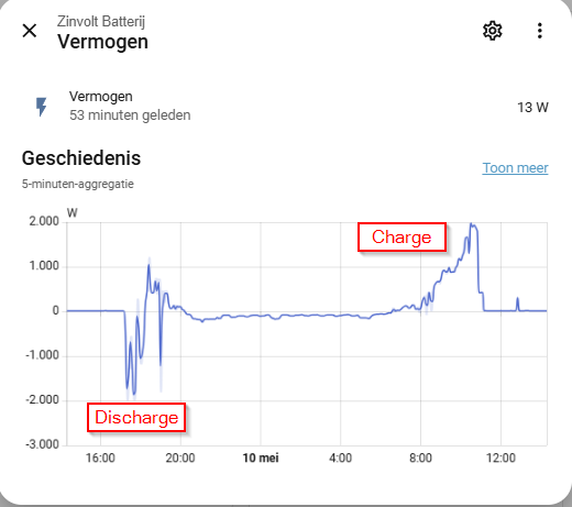

I have an battery from Zinvolt.
I have the Zinvolt intergration done.
Now the only sensors are:
  • Percentage of the batterij
  • Current power
    In the screenshot you can see this one.
    If it is negattive it's discharging the battery.
    If it is positive it's charging the battery.
Putting info into the energydistribution needs a 'sensor' for charging power and dischargingpower.
I've been playing with helpers but not succesfull.
How can i split the charging and discharging?
  • Helpers?
  • Scripts?
Can anybody help me on the way?
Gerrit

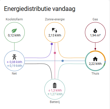

@HAEdwin thank you.
This did it.
here a screenshot of the energyboard.
I had installed your HACS: Zinvolt P1-dongle PRO – Home Assistant Integration but they gave the information from the net import/export not from the Zinvolt battery.
Nice! Indeed this is for the time being, I heard the developer will improve the Zinvolt integration by adding functionality when there is enough info received from Zinvolt.
