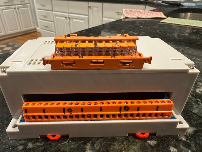

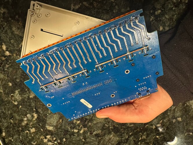

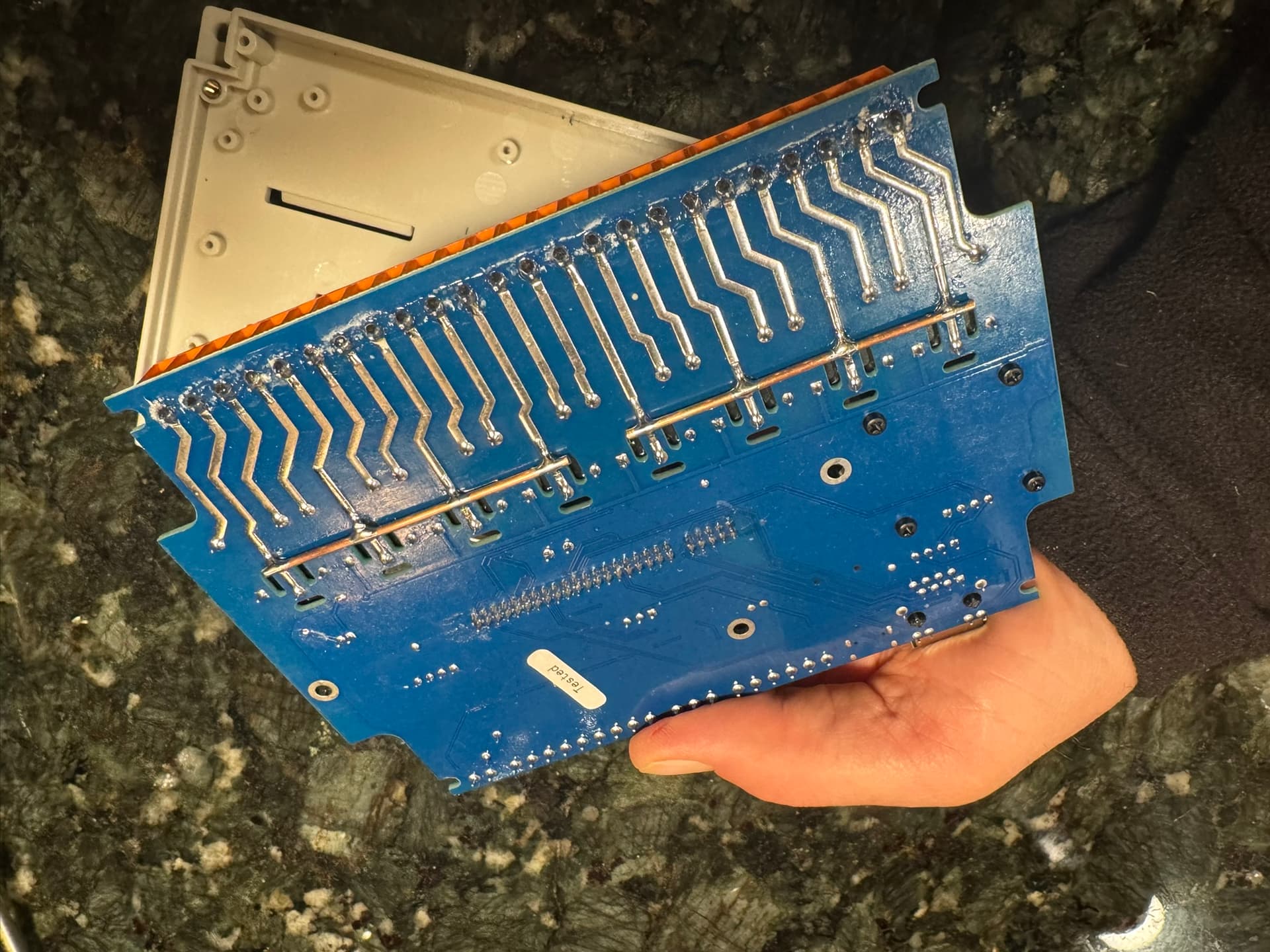

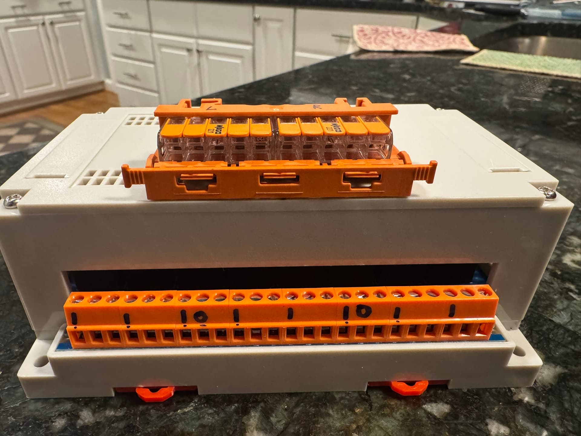

A bit of research led me to find Kincony’s ESP32 8 Channel Relay module. After installing ESPhome and loading Kincony’s yaml file for this module, I began by testing the configuration with a single set of speakers. They sounded great so I took the plunge and soldered the main board to interconnect the left & right speakers’ red “+” leads to the COM relay input (see attached image). The black “-” leads for left and right speakers are then connected each to their respective 5 pin WAGO connectors (see attached).
It’s been a couple of weeks of reliable audio (and no fires!) so I figured I could share with the community. My biggest regret is that this module isn’t POE :frowning: and that I hadn’t done it sooner. Happy to help anyone who is interested in doing the same and welcome the community’s feedback.
