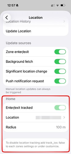

I’m trying to understand why Zone only location reporting works on my iPhone, but not on my wife’s.
We both have the same iPhone model with the same relevant setup (Home Assistant Companion App, WireGuard VPN, Location permission: Always, Precise Location enabled, Backgroud App Refresh enabled).
On my phone, the setting Companion App > Servers > Privacy > Location Sent > Zone only works correctly. Home Assistant detects when I’m home or away.
On my wife’s phone, presence detection only works when Location Sent is set to Exact. If I change it to Zone only, Home Assistant reports her as away even when she is at home.

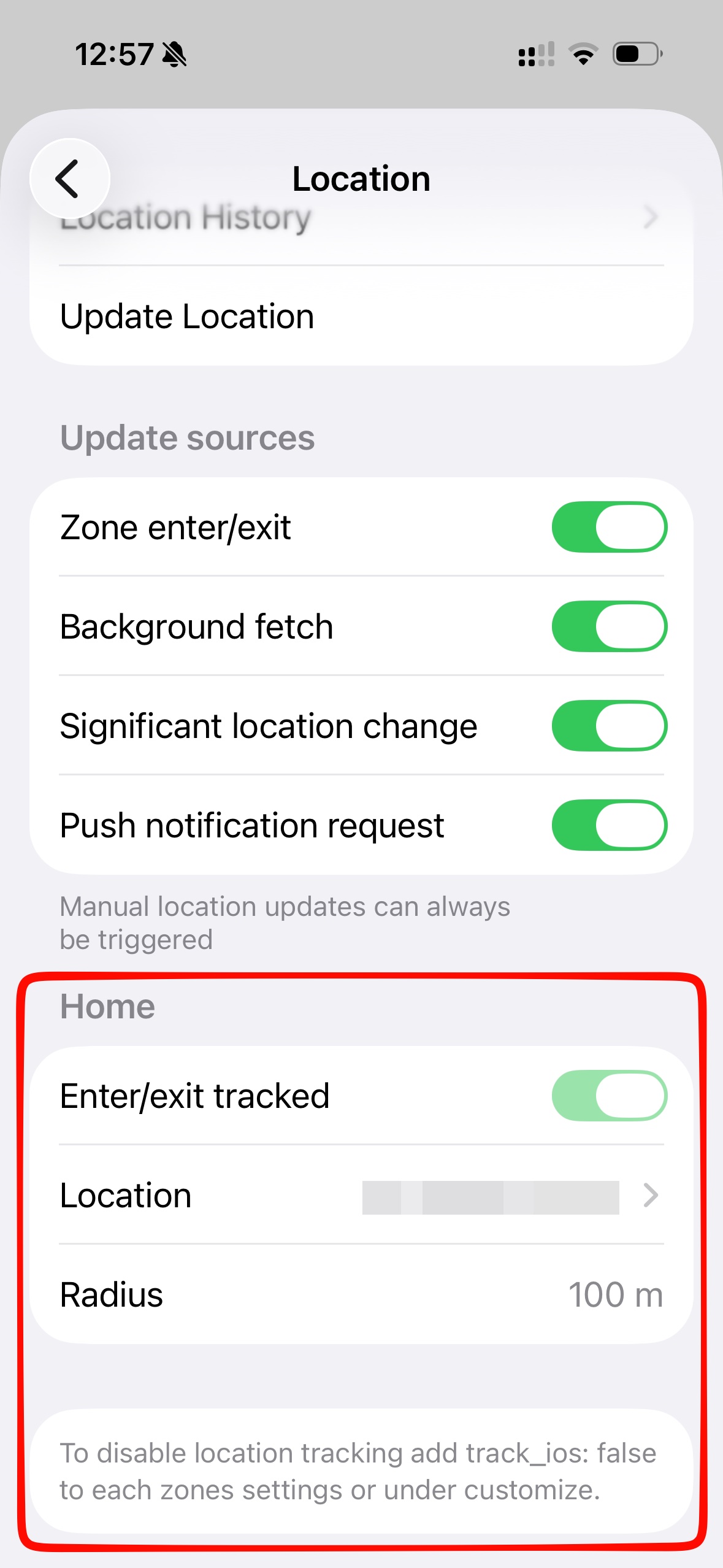

The main difference I found is under Companion App > Location: On my phone, I see a “Home” section (showing Enter/Exit tracked, Location, Radius).
On my wife’s phone, this entire “Home” section is missing.
I’ve already tried the usual troubleshooting steps on her phone (Log out and back in, Temporarily make her an administrator, Reinstall the Companion App). Unfortunately, without luck.
My assumption is that her Companion App does not know about the Home zone locally. So for her, the zone detection only works when exact location is reported and the Home Assistant server can decide whether she’s in the Home zone or not.
I’d prefer to use the more privacy-preserving Zone only setting on her phone as well.
Does anyone know why the Home zone would be missing from the Companion App’s Location settings and how I can get the app to recognize/track it again? Is there another requirement for Zone only reporting that I’m overlooking?
