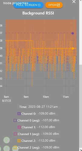

My Razberry 7 pro (FW 7,38)is running nearly perfect. The HA yellow has absolute no interference issues. You can check it in the network graph:
Values around -110dBm are really good.
This allows me to reach almost all of my 40+ devices directly.
Seems that the external antenna makes the difference(or the FW version).
