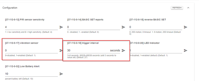

Select the device in zwavejs2mqtt, expand it (down arrow) and scroll down. Expand the Configuration section.
mine doesn’t look like that.
Mine is running firmware 2.1 according to z2m. Their support site says it cannot be upgraded to that OTA. If yours is older perhaps Zooz support can assist with an exchange.

It is a motion & vibration sensor. I disabled the viration sensing since I do not need that & to preserve battery life. The wakeup interval is the default 43200 seconds.I have set the Trigger interval slightly higher than default to 30 seconds. I have considered disabling the LED to further preserve battery life.
