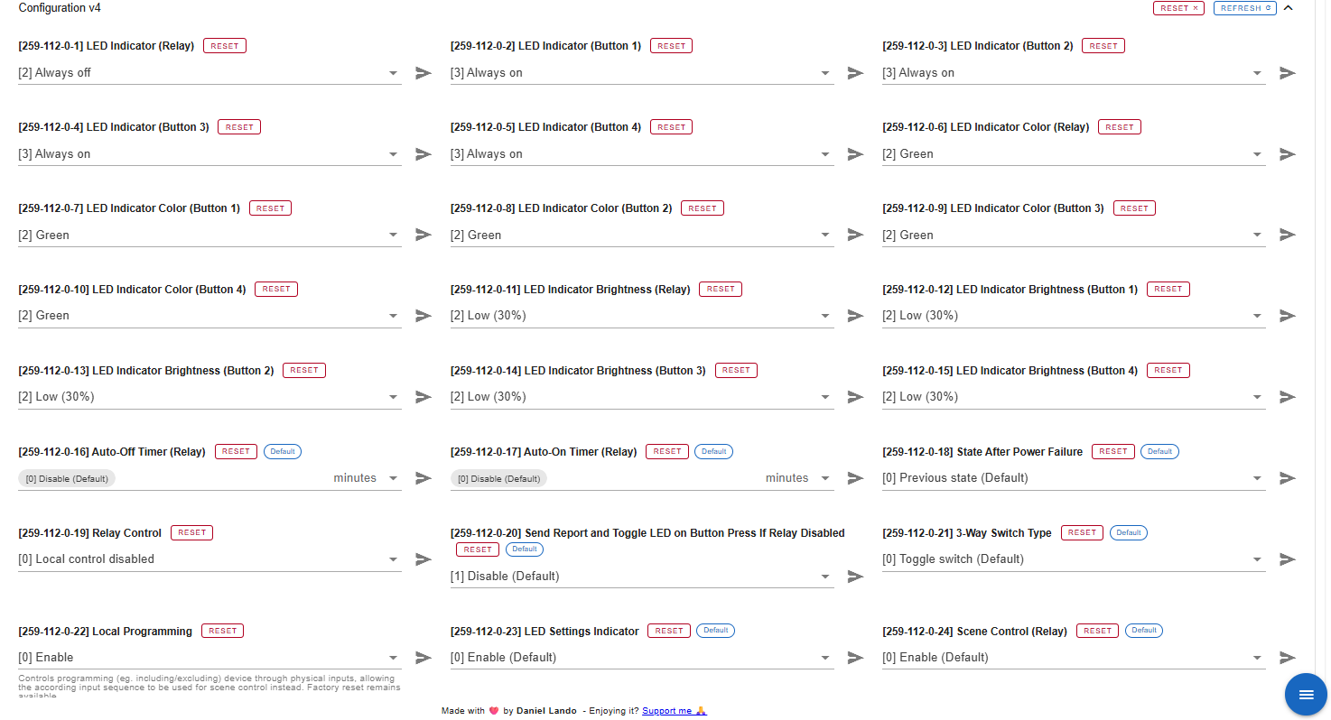

Huge thanks to @rwalker for this blueprint. Makes things so much easier to setup. I was wondering if anyone had some info or something I need to change to have the large button 5 light to turn off with the smaller leds at night. I notice it will always remain on at night.
Thanks in advance
By default the LED of the big button tracks the relay. What do you want the behavior to be?
Hello @rwalker. I currently have my relay turned off. I use this to control the light in my ceiling fan or in another Zen32 I have it control a Govee patio light. Is it possible the light would still turn on and off with the time of night light. Basicly how the smaller buttons will all follow that on and off for day and night
If you have the relay control disabled, then it should work. My guess is you have a Z-Wave setting incorrect. Double check those and if you are still having issues, post them here I can tell you what to change.
I have checked all settings and not seeing anything that would cause this to not work. All buttons are setup the same way but the larger main button light will never go out. Here are my settings:
Try setting option 20 to enabled. I assume you have updated firmware? Latest is v2.40 (was a bug a long time ago that caused your issue).
That was it. Option 20 changed to Enabled. My Zen32 is on the current 3.20.1 firmware.
Thanks for the help @rwalker
