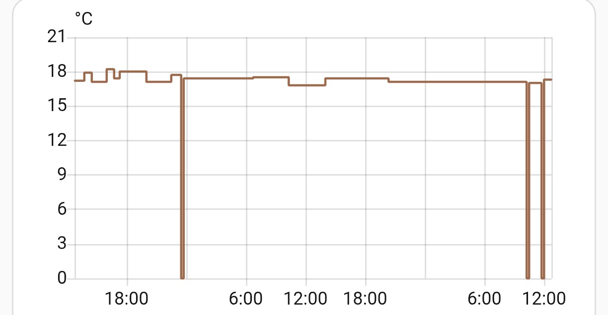

Did you get anywhere with this? I am in contact with zooz about it. After a while the readings stopped jumping around and stick at 0C (32F) forever now.
They have asked me for a report which I have sent. My gut feeling is they suspect the firmware, but no official word back yet. I’ll post again when I hear more.

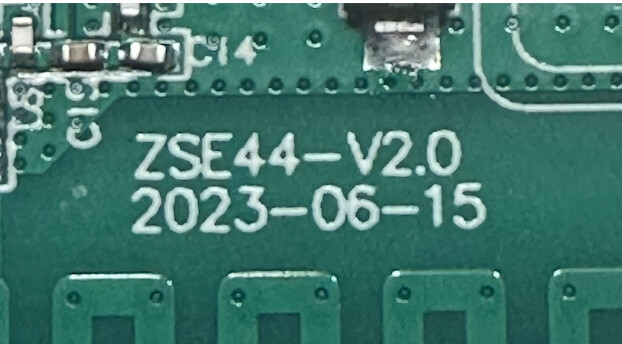

What date codes do you have on yours? The ones I checked are stickered 0324 on the back, and the date on the PCB is 2023-06-15 - including the bad one.
Yes, mine ZSE44s have the same dates on the sticker and PCB board. Who knows, maybe that issue was there on all of them since the very beginning and we just didn’t know about it, because it was masked. When they updated the firmware with the new Z-Wave SDK, they might have accidentally removed that “fix.” So, they rolled out fast a new firmware release with a new “fix,” but they screwed it up badly.

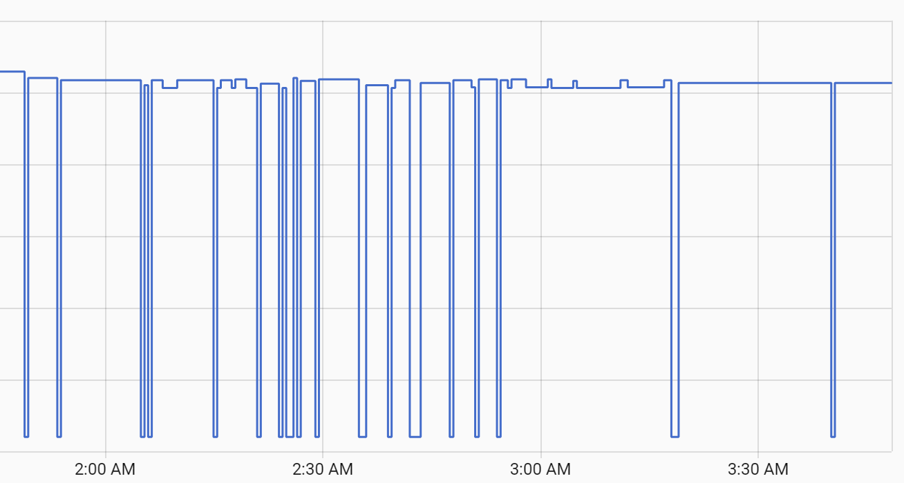

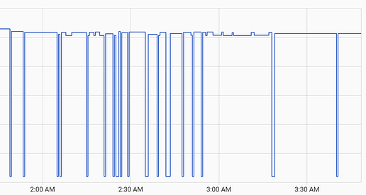

I had forgot about this: I have a z-wave thermostat where the humidity would also have these brief, crazy wrong readings. Getting Honeywell to address it seemed impossible, so I created a sensor to filter out the bad readings.
But my drop-outs were like five or six a day, not like the graph @DataMeister posted above.

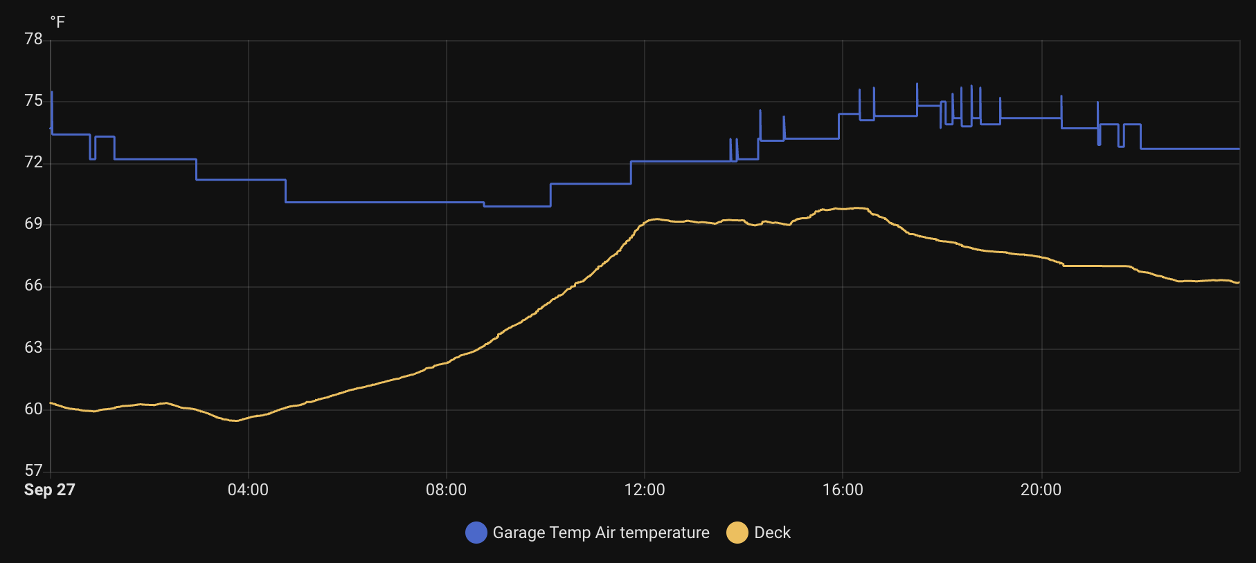

I have a bunch of temp and humidity sensors. The ones I built with ESPHome tend not to be very accurate but good enough, and I also have five SensorPush sensors that seem very accurate (as well as precise) and update frequently, if one needs that.
“Deck” below is a SensorPush sensor, and “Garage” is a ZSE44:
