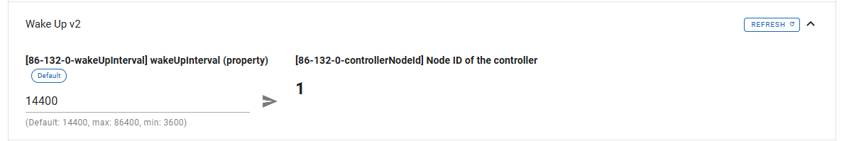

The device claims to be sleeping and is set to wake up at the default interval of 4 hours. As far as I can see, all the other settings are set to their defaults.

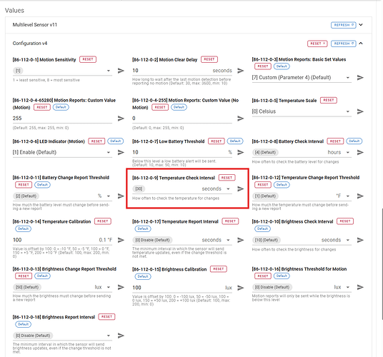

Hmm, I have this:
But also this:
Checking every 30 seconds seems excessive - I’ve not set this myself - perhaps turn it down?

Even the default values look excessive to me,like brightness measurement interval 10s(default).
Also the brightness change report interval 50lux sounds stupid, if you have clouds moving over clear sky it can trigger continuously.
I put everything to the default settings yesterday and replaced the batteries. A day later, and the battery level has dropped from 100% to 76%. Something is definitely wrong, but I can’t see what.
