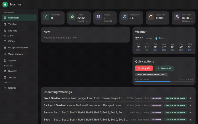

Zroshua is a native Home Assistant add-on for irrigation — a full web UI in the sidebar, zones built on top of your existing switch / valve entities, watering groups with controlled concurrency, a scheduler that understands your hydraulics, weather and sensor logic, statistics and a Lovelace card.
Dashboard

Planning is predictive, not just a list. Temperature scaling can stretch a run, so the timeline reserves the worst case: each run is drawn with its planned length plus a hatched worst-case tail, and gaps after the tail are guaranteed free. Upcoming runs carry a red will skip badge with the reason when they’d be skipped under the current state, and a yellow may skip when it depends on data only known at start time. Every start time is either start at or finish by — pick the latter and the start is computed backwards from the worst-case length, so “lawn done before the 07:00 school run” stays true even on +20 % days.
Everything is journaled. Started, finished, every skip with its reason, temperature adjustments, faults, reconciliations.
And some things I just wanted for myself: a site map — draw your property as an SVG in Figma/Inkscape, upload it, tap shapes to assign them to zones (a zone can be several shapes); fill colour is the watering type, brightness/animation is the live state, with remaining minutes drawn on the zone. Plus water/energy/cost statistics with CSV export, Telegram and notify.* notifications with per-target event filters, group-level notification mode (13 beds = 2 messages, not 26), a daily digest and quiet hours.

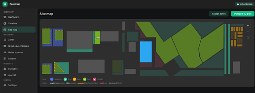

One image per post as a new account, so the map goes separately.
This is my own plan, not a demo: the 32 zones exactly as they are in the garden — lawn, beds, drip lines and shrubs, fed from a well and a rain barrel. I drew it in Figma and exported a plain SVG. The shapes had no ids; Zroshua adds them on upload, so you just pick a zone and tap the shapes that belong to it. Some zones are several shapes — the lawn is split by a path, one bed is two rectangles — which is why a zone binds to a set of shapes rather than to one.
Fill colour is the watering type, brightness and the pulse are the live state, with the remaining minutes drawn on a running zone.
