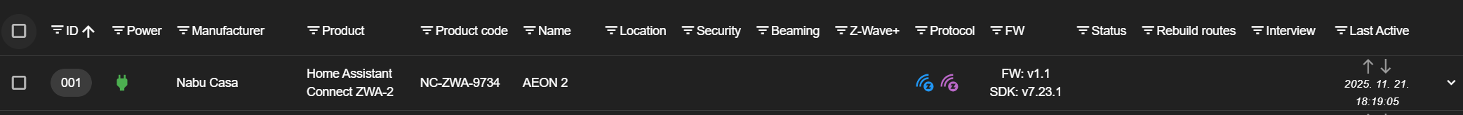

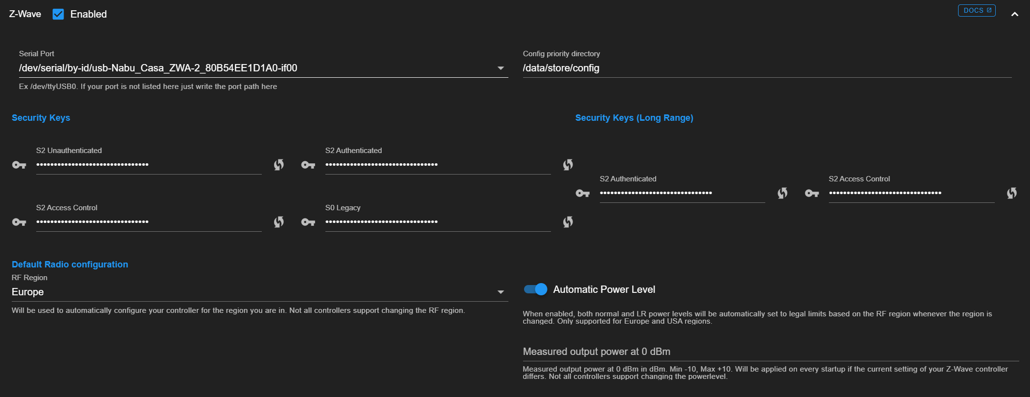

ZWA-2 USB zwawe stick with zwave LR support.
All system and firmware is up to date.
Home Assistant: 2025.11.1
ZWA2 NC-ZWA-9734 Firmware 1.1 SDK: v7.23.1
Zwave JS UI 6.0.0
Aeotec Home Energy Meter 8 ZWA046 FW: v1.7.6 SDK: v7.22.0

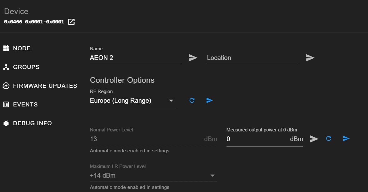

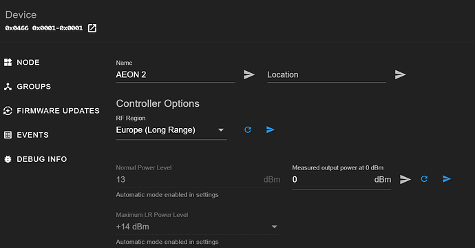

I’m in Europe, I set the region to Europe in the zwave-JS Ui.
I was able to configure the z adapter without any problems, I migrated my existing zwave gen5 network to it.
In the adapter device settings set Europe LR
I have 1 power meter, new, but I can only adopt it as a regular zwave device. In S2 mode for example. It also says that it is ok.

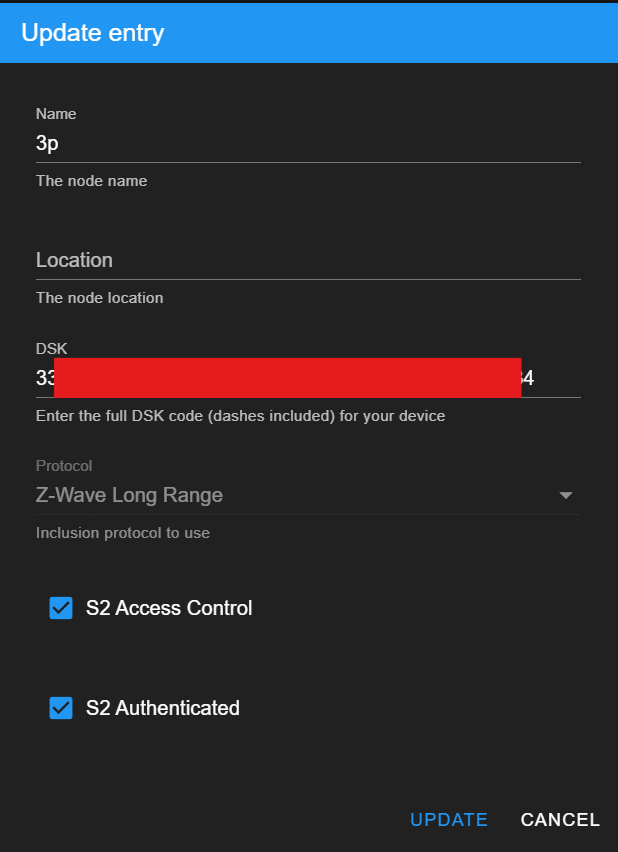

I would like to try it in LR mode. I excluded it, and I added it via the zwave js ui interface, from the mobile application with smart start. When adding it, I selected zwave LR as the protocol, but it doesn’t want to work. It seems to add the device, DSK is ok, but it only works in zwave mode.
I activate it in vain in the Smart Start menu. I tried to deactivate it, but I can’t change the protocol.
Thanks
I always get only “SmartStart_HomeId_Received”.
I don’t see anything like “SmartStart_LongRange_HomeId_Received”

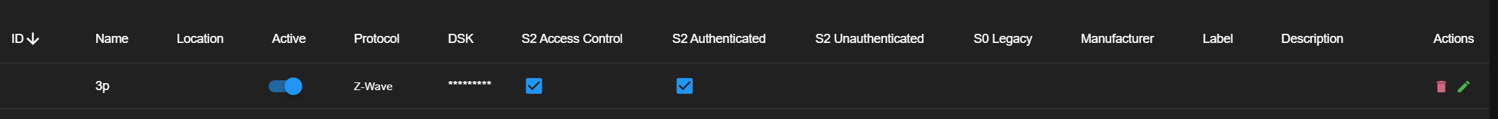

The DSK is included, and the Zwave inclusion protocol is selected as Zwave Long Range, but the summary interface in front of it only says zwave.

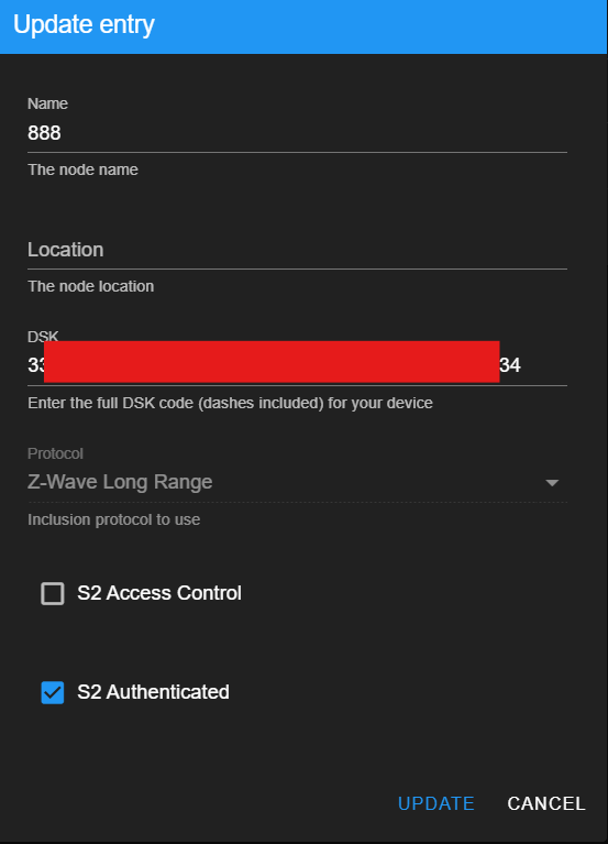

Here I set Z-wave Long Range:
Here I see only zwave
If I don’t select Zwave long range for the protocol, but just Zwave, the controller will pick it up just fine as a normal Zwave device.
Why?
