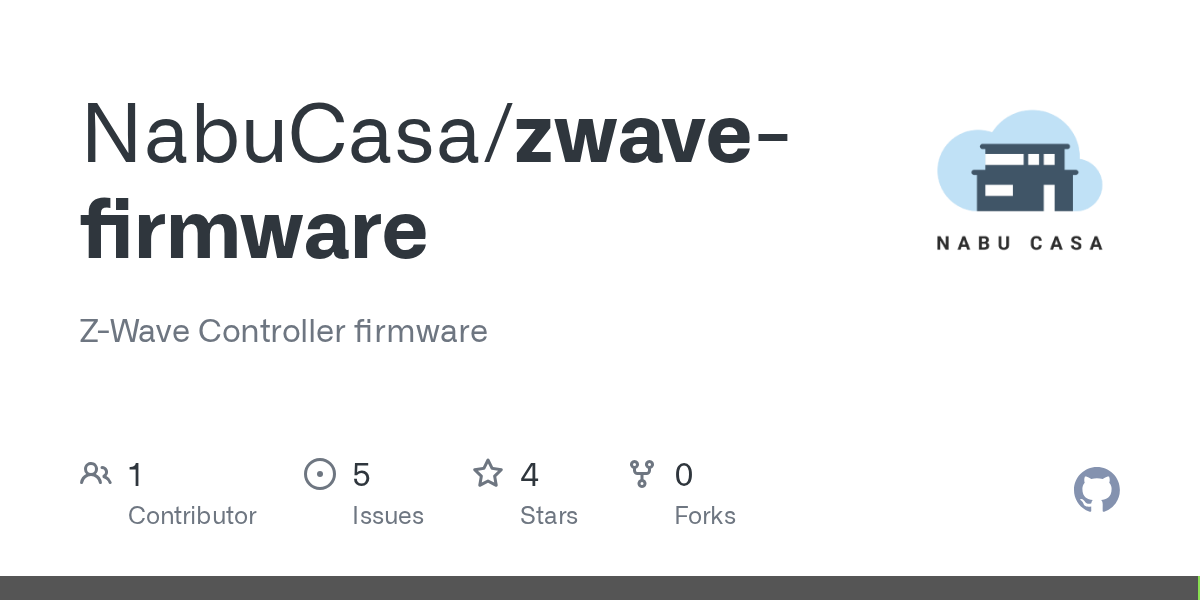

Below is firmware to reflash
Did you get nvm backup
Before you tried update?

Thanks to point the location of the firmware, but I need the command line to complete the upgrade.
