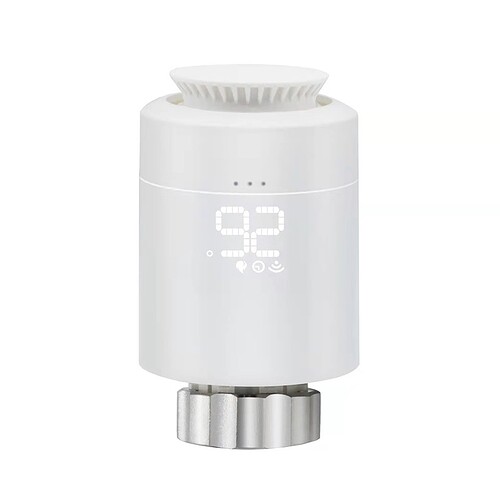

For this device i will just change the battery after 10 years ??
currently i am to change it every years
