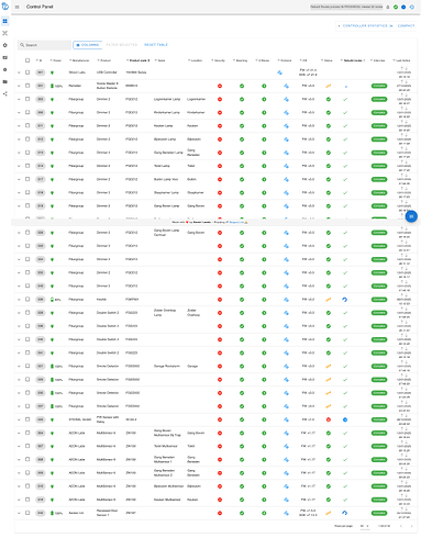

I’m just curious. Could you help share your zwave network graph, and/or maybe the Control Panel in your zwaveJS UI and show us all the columns?
Yeah, sure. Side note, it would be nice if the node names would sync between HA and zwave JS :slight_smile:
