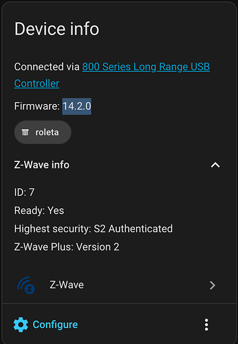

This is the sample info for the old HA device for same zwave node:
And for the new HA device for same zwave node:
As you can see, they are the same zwave node #7. Blind controls are present only for the new HA device. Also, sensors work for the new HA device only. I disabled the old device manually given it is not usable.
