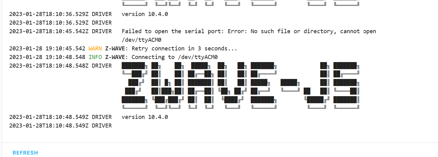

all the time i upgrade zwave i get an error as below; the fix is manually remove zwave stick from usb port and attach it again … why is that happening?

Try using the /dev/serial/by-id path for your USB path. /dev/ttyACM0 is not reliable.

Use /dev/serial/by-id/usb-0658_0200-if00 in your add-on configuration, not /dev/ttyACM0. The latter can change to /dev/ttyACM1, etc… if it’s unplugged/re-plugged, or you have other USB serial devices, which would result in the not being found error you’re seeing.
If that doesn’t turn out to be the issue, you’ll need to start looking into why your USB device becomes disconnected.

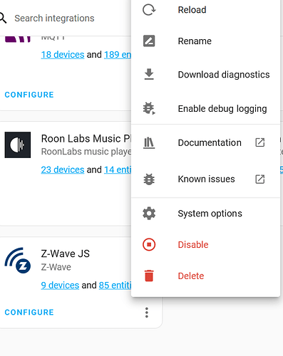

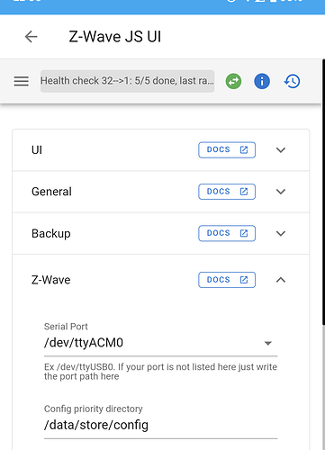

In the add-on. UI has setting and then zwave to put serial port.
What you have there is the integration
thanks a lot! all set, lets see what will happen after next upgrade.
