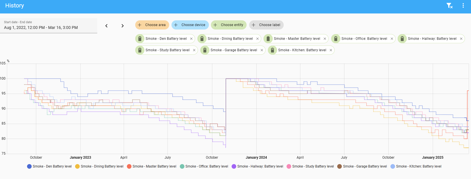

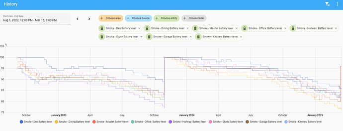

Thanks for sharing. Based on the text messages (only record I have lol) it looks like I change all of them in December of last 2022, so with a little over 800 days, I guess it make sense that it’s time to change it. The rest of them are still around 80-83%, the one that was going off is in the Master which the Alarm sounds quite frequently due to the steam from the shower, so it makes sense why this one would be lower.
This very helpful information, I think I’m going to swap them out when they hit 80%.

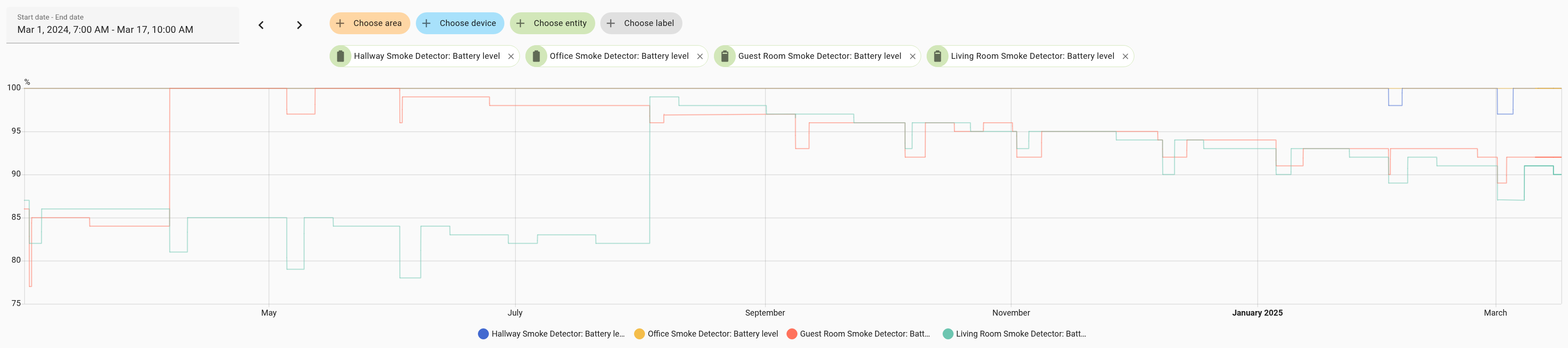

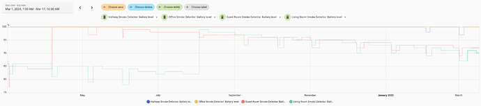

Here’s a year’s worth of reports for my 4 alarms:
Two of the devices report 100% over the year, these have lithium AA batteries which you aren’t supposed to use since it does affect the reporting (levels are based on battery voltage) (I’m not too worried since I test monthly, but I should switch back). The other two have regular alkaline batteries and normal reports decreasing reports. Going back more than 1 year in the history I only change the batteries after more than a year.

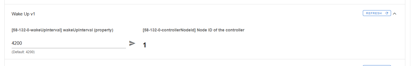

At least with the version 2, it looks like you can change the 70 second wake up interval through Z-waveJS
Here is my historical levels:
The dialog box allows you to change it, but it’s not configurable. Min and max are both 4200:
      "id": "11-132-0-wakeUpInterval",
      "nodeId": 11,
      "toUpdate": false,
      "commandClass": 132,
      "commandClassName": "Wake Up",
      "endpoint": 0,
      "property": "wakeUpInterval",
      "propertyName": "wakeUpInterval",
      "type": "number",
      "readable": false,
      "writeable": true,
      "label": "wakeUpInterval (property)",
      "default": 4200,
      "stateless": false,
      "commandClassVersion": 2,
      "min": 4200,
      "max": 4200,
      "step": 0,
      "list": false,
      "value": 4200,
      "lastUpdate": 1740876856107,
      "newValue": 4200
Pretty sure I tried to change it and it just gets ignored.
