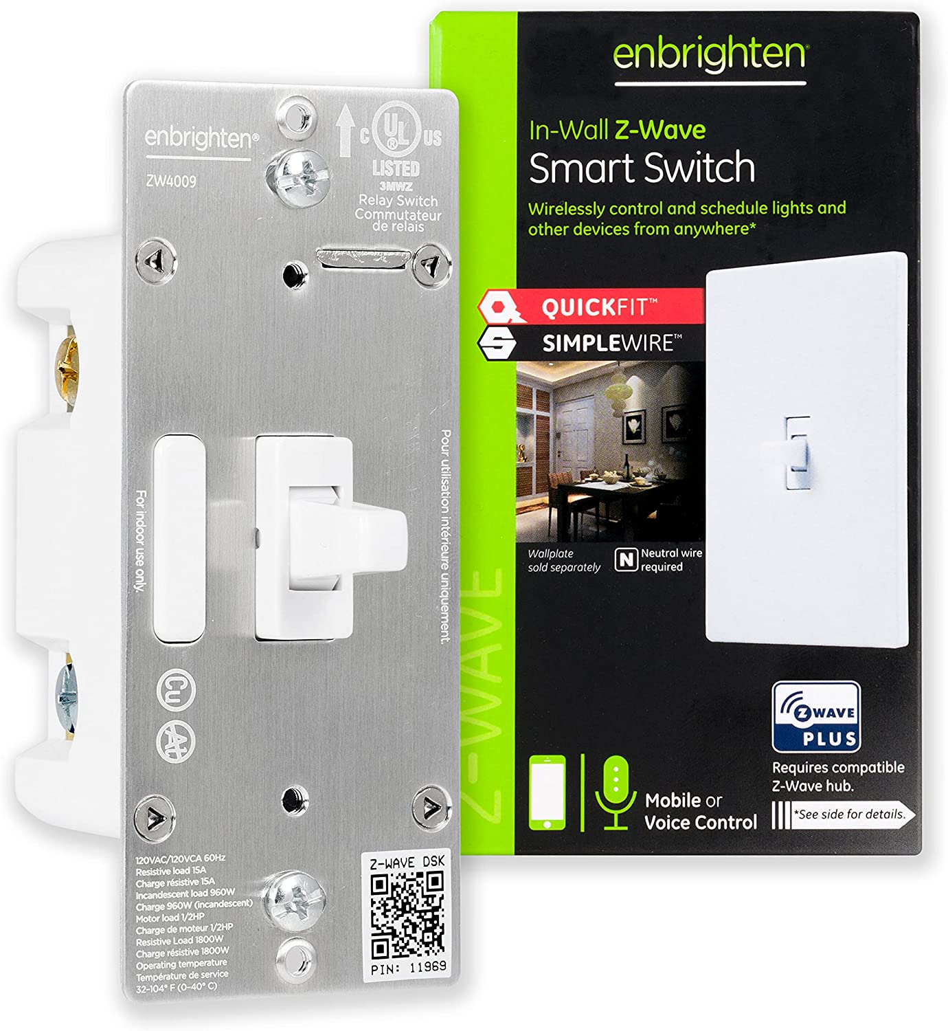

instead of using external modules, have you considered replacing the wall switches themselves.
Here is a link to a Z-Wave 3-Way (or 4-Way) switch:
and here is a link to the corresponding switch completing the 3-way or 4-way circuit.
The beautiful thing here is that it can be installed as a 3-4 way switch OR a 3-4 way dimmer. They work like a charm and even the dimmer function is 3-way. If you are interested, please let me know and I will guide you as I have converted most of the house with these switches and all controlled by Alexa and Home Assistant.
