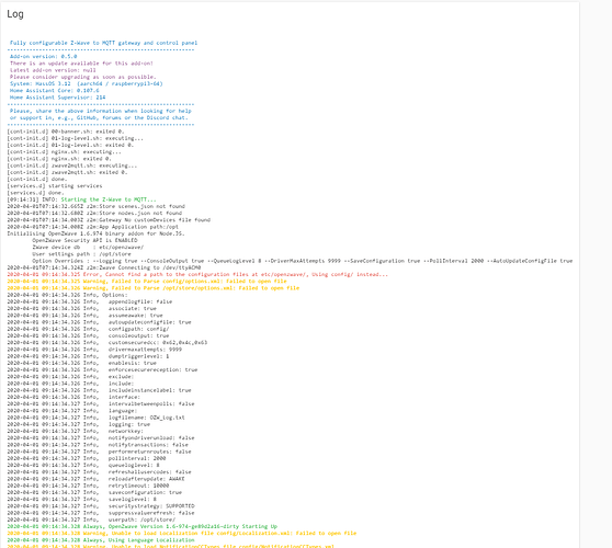

Edit/TLDR: main problem: all nodes in Zwave2MQTT appears as “dead” after some time. Everything seems to be working up until then, despite some error messages in the log.
Running Rpi 3b+, with Aeotec stick gen 5. Memory card recently fried, so I’m starting over, and was adviced to use Zwave2MQTT.

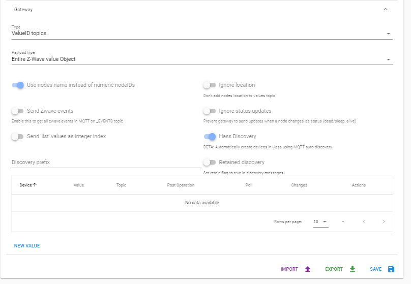

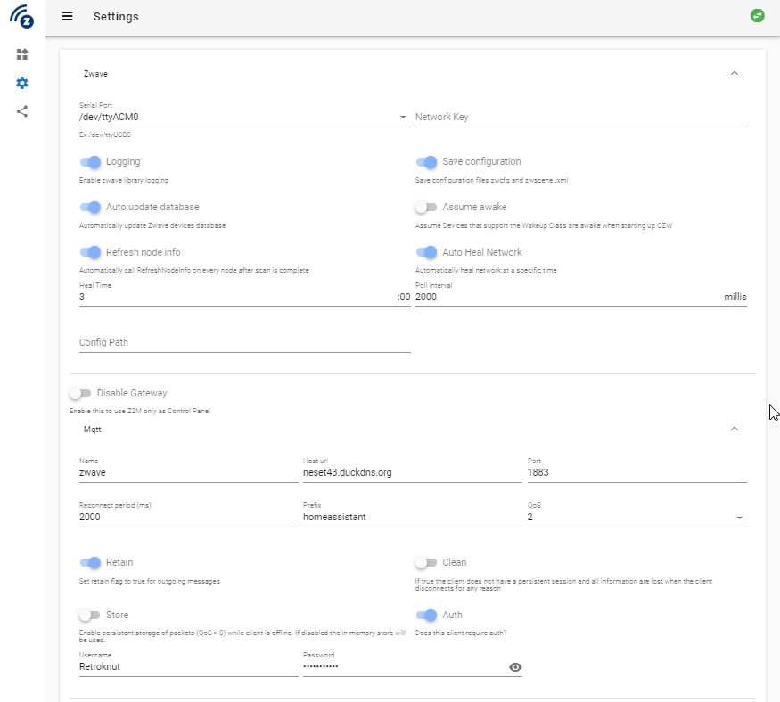

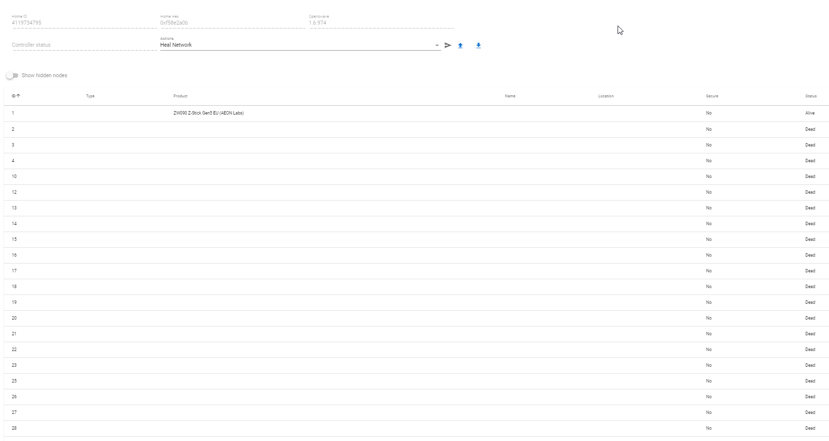

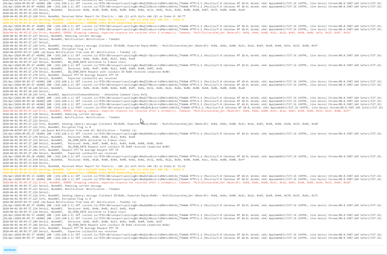

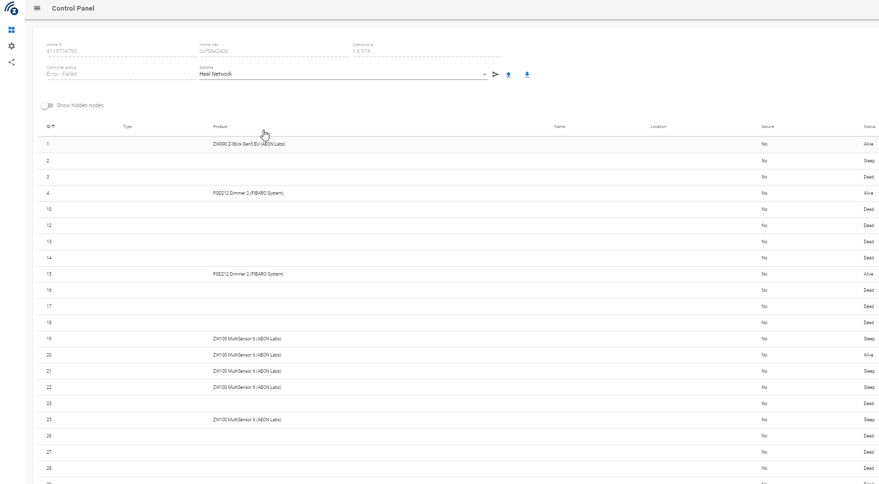

I’ve attatched several screenshots of the zwave2mqtt configuration, a screenshot of the log from the zwave2mqtt add-on, and some screenshots from the node list in zwave2mqtt and home assistant.

  2. When the add-on is started/restarted, the process often freezes, and I have to restart the add-on. Then it might populate the entire list of nodes with names. After a restart I can see the list of 44 nodes, but at first it’s empty, then it fills our with either “unknown” or dimmers/multisensor etc. The “unknowns” are later updated to dimmer/multisensors. But like I said, this freezes form time to time. Normally the population process stops half way through.

  7. update: most recent observation: after being away for 15 minutes, I saw the entire list populate with names in zwave2mqtt, but upon refresh the entire list was empty except for the z-stick. (last image). The log still updates with similar lines as shown in other screenshot. Is there some way to export the log somehow?
