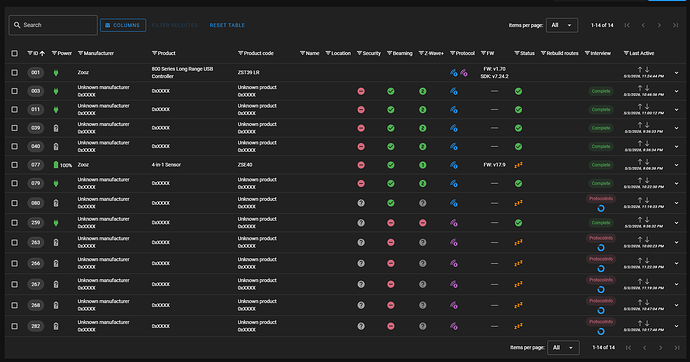

I have two zwave controllers running on raspberry pi’s, split between parts of the house. One of them failed today, the SD card is completely unreadable.
I have rebuilt it on a new card, installing the software/dockers, and have it running. When it started it found the controller and has all the current nodes identified, and is … well, doing something.
It is connected to Home Assistant, but almost everything shows not available. Some devices show their name, some show “Node 3” and similar. I could rename them but I do not see why they are unavailable. Some of the unavailable ones are mains powered, not battery.
Do I need to just give this more time?
I had the zwave software backing up, but it was of course backing up to the sdcard (at least I assume that’s where it went). I think that’s just backing up the controller’s nvram anyway.
Keys?
When I rebuilt it, I generated new keys. I’m guessing that was wrong. Are they keys anywhere in Home Assistant to access and put back into the config?
Note node 259 is an LR node, it shows a ? for security, but shows “complete”. It’s mains powered (and a light dimmer).
is there anyway to recover these without disassociating each, and re-adding, and then setting up all the entities names and automations and… oh please tell me I don’t have to do all that again… ?

I tried all of that. It’s like they were there, but HA would not talk to them. Some were in the process of interviews (waking them did not fix it), but some had completed interview but were still just showing as NODE_3 (etc) in HA with every entity unavailable. Indeed, until I re-added them despite re-interviewing most did not show manufacturer, type, etc.
The communication protocol (this is a guess) must allow it to see the node, but not talk to it without the S2 key.
They came right back up when I excluded and included them (but I had to redo HA’s entries).
