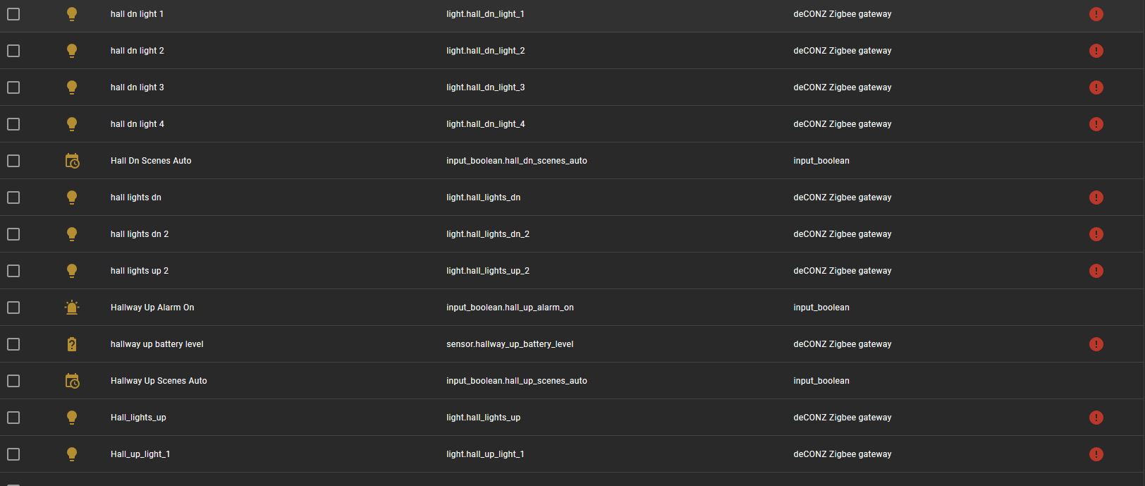

KennethLavrsen
My upgrade to 0.104 was messy
There is a bug that triggers when you upgrade.
All my deconz light groups were suddenly duplicated in the Deconz Integration
And this resulted in all those light groups to be duplicated entities also all with suffix _2
And the result was that no light automations and no dimmer switches worked any more.
To clean it up I had to delete all the original entities which you can do from the UI.
Then I had to rename all the _2 to the old names
And finally I had all the duplicate Deconz groups that I had to delete. And again - the only way you can delete them is to stop Home Assistant and hack the JSON file core.device_registry in a text editor.
We really need a feature so you can delete not only entities but also devices.
Why were all the Deconz light groups duplicated? And will it happen again?
Edit. I checked the last backup of core.device_registry from just before the upgrade and there was only one instance of each Deconz groups. No old cruft. This happened during the upgrade

January 2020 ▶ KennethLavrsen
guedeaux
I had the same issue with deconz groups.

jamesking
For me, I have the deconz all lights group and it is duplicated, but then I also have “lightgroup” light groups. I do use deconz, but I also have some light groups made up of both zigbee lights from deconz, and zwave lights fro ZWA, and I am getting duplicates of those lightgroups too. Group - Home Assistant

January 2020 ▶ WhistleMaster
KennethLavrsen
Note
I cannot comment on duplicated input_booleans.
It was noted in the release notes the breaking change of old dormant ghost entities that could show up. For things that are related to that I would just bite the bullet and fix it once and for all.
The Deconz issue is different because it is not old dormant entities that suddenly show up.
It is at device level all groups from Deconz get duplicated.
It has nothing to do with the Deconz Addon changes that Frenck did recently. I run with a Deconz outside the Home Assistant realm where it is a pure API connected from Deconz to Home Assistant. Deconz was not even restarted in connection with the 0.104 upgrade.
The issue seems to be that in 0.104 something changed that make Home Assistant re-discover all Deconz groups as if they were new groups and in that action it leaves all the existing groups orphan. But since there are already entities associated with the old groups all the new groups get associated with new _2 entities and then the whole system breaks down because all automations and front end refers to the old now broken entities.
To fix the deconz specific issue do this in this exact order.
Go to the Integrations page and open the Deconz Integration. You now see all your deconz devices listed. You can easily see the duplicate light groups.
Walk through each duplicated group and click on the first.
Verify that it has an entity associated with it not ending with _2
Delete this entity
Give this old group Device (not entity - device!!) to a name that we can later find. I called mine the old group name appended by crap (that was my mood in the situation). Use a string that is unique
One step back and open the other new group device
Rename the associated entity to same name but remove the _2
Note that you have to delete the old entity first before you can rename the new _2 because you cannot rename to an existing name.
Do this with all the groups.
In principle all works now. But you still have some old “cruft” devices in the core.device_registry that you cannot delete from any user interface. I am sure that will haunt you again in future and can cause more duplication to occur. The only way to delete deconz devices is to hack the JSON file
So next steps are…
Stop Home Assistant to avoid hacking live data.
Go to .storage and save a backup of core.device_registry
Now open the core.device_registry in a text editor and search for that name you appended to the old devices (crap in my case).
Now carefully delete the entire JSON object that contains this crap device. Be careful with the commas. Especially if it is the last member you delete. There can be no trailing comma in the list. That is why we saved a backup in case we goof up. Hacing JSON is horrible but it is the only way because Home Assistant still has no user interface for deleting devices. It is only entities we can delete in the user interface (which also means that each time a light bulb fails and I buy a replacement, I have to hack JSON files to get rid of the old).

January 2020 ▶ jamesking
KennethLavrsen
I have a few https://www.home-assistant.io/integrations/light.group/ type light groups also. And mixed with non-Deconz lights. I did not get any duplications of those.

Edit: still had a config entry in configuration.yaml. Removed that and rebooted, now it’s working.
Edit 2: in the process of re-adding (and probably a update on the hue bridge), all my lights have different names! In addition that the groups from the hue bridge also disappeared (except adding a config entry - I just removed that entry to get it discover any lights at all!).
This is a major breaking change and can cause quite some downtime. Please adjust the breaking change section accordingly.
1 reply

Had the same thing on unraid docker image for homeassistant, downgrading to 0.104.0 and hue is working again.

KennethLavrsen
For this that have not yet upgraded OR have reverted back to previous version.
Robban has explained that the issue is a side effect of a code change he did (side effect that he had missed - hey we are all only humans :wink: ) and he has described a manual hack of the core.device_registry that you can do BEFORE you upgrade.
In short - the issue is that from 0.104 the Deconz integration generates internal references to groups with a new method and if you already have groups defined you end up with duplicate groups. Robban’s workaround is to stop Home Assistant and hack the Deconz existing group reference to the new format (which is removal of 4 F’s in a hex number).
This only works before you upgrade Home Assistant!! See the link and also follow the next 10-15 comments. It is hacking of a JSON file but much less trouble than the clean-up I describe that you need to do AFTER the duplicate groups have been created.
