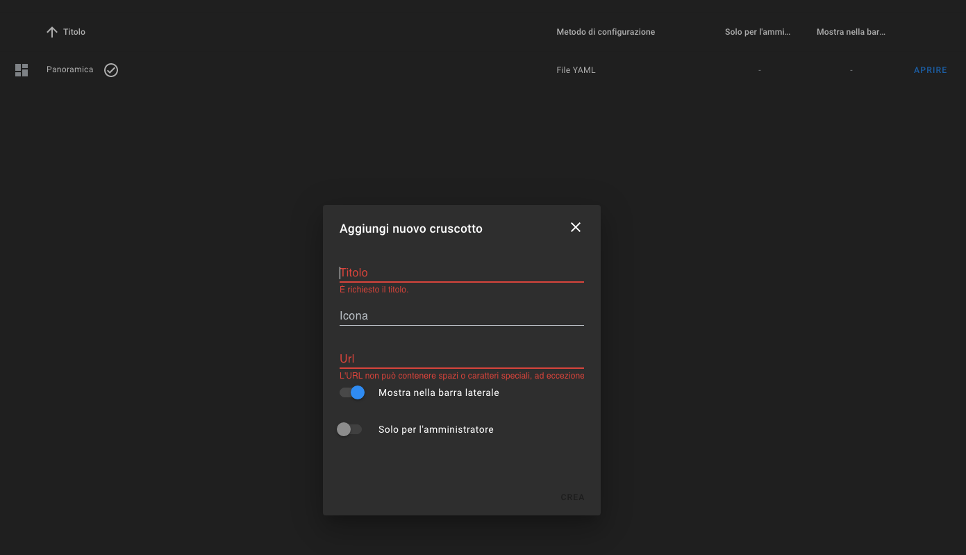

Hi all
I don’t understand how to create new dashboards.
Actually I use YAML mode and I would like to create an autogenarated dashboard and one for mobile/tablet.
What should I put in the url field?
Should I create a new folder for each new dashboard?
And last question, where can I choose to have an autogenerated one?
Thanks

Nice - however cannot find anywhere how to " create a new Lovelace Dashboard"
I don’t have " ui-lovelace.yaml" - only configuration.yaml and whatever is done through “Raw configuration editor” ( where is this file anyway? - ubuntu/docker/ha)
Should be in Configuration > Lovelace Dashboards…just click the big + to add a new one.

how about doing it manually - the docs have it.
actually, don’t think YAML mode page is the right place for this bit of information as it clearly says
You can also add YAML dashboards when your main dashboard is UI configurated
