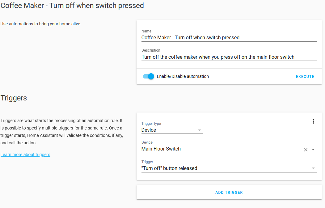

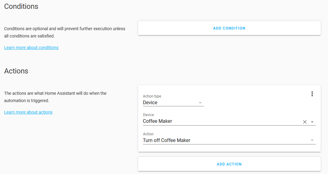

Wait, thatâs a Hue Switch, right? Not a Smart Button. There are no triggers except the battery status for the Smart Button.
