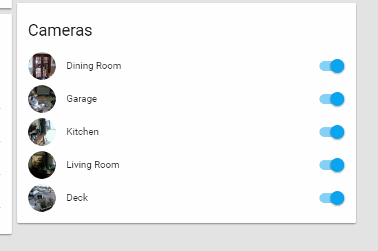

Everything seems OK except now my cameras (using the Foscam platform) are no longer showing as a full display on the frontend. They now only show as icons with a toggle. Once I click on them they show a normal view in the pop up window.
ex
How can I get them to go back to a full view like before? I don’t see anything about this in the docs or in the breaking changes for this release.

using custom_ui? see: Weather on 0.81.0.dev0 (0.81.1) shows camera as switch..? - #2 by Mariusthvdb
Awesome! Thanks for that info!
It fixed not only my camera’s but also my history-graphs and media players that I hadn’t even noticed that were borked, as well.
