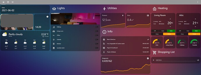

My Lovelace overview
  • Date card: Vertical stack with
    • A sensor card (sensor.date). Haven’t figured out a way to change this from YYYY-MM-DD to DD-MM-YY
    • A grid card, consisting of two picture cards (presence detection through device tracking by my router) and a time (sensor.time)
  • Weather card: stock weather card in Home Assistant
  • Lights: Philips Hue, card is Vertical stack with
    • Markdown for the icon and the title
    • Stock entities card with a header
  • Utilities: Aurum Energyflip, card is Vertical stack with
    • Mini Graph card on utility consumption by kalkih
  • Info: Vertical stack with
    • Stock entities card with garbage disposal stats by xirixiz
    • Cryptoinfo through a stock line graph card by heyajohnny
  • Heating: Tado, card is Vertical stack with
    • Heating controls through Simple Thermostat card by nervetattoo
    • Temperature gauge grid card, from various Tado and Hue sensors in the stock Gauge cards
  • Shopping list: Vertical stack with
    • Stock shopping list
  • Second tab is a stock fullscreen Google calendar card
Background & UI is IOs Dark mode Theme by basnijholt

The dashboard
During my research, I found various photos of wall mounted tablets. I could already imagine myself trying to press tiny buttons on my dashboard or having to convert my lovelace UI to large-finger-proof tiles. I like a smooth, slick UI, and therefore couldn’t settle for anything less than 15 inch for a touch screen. #1stworldproblems.
Go big or go home(assistant)
I soon found that tablet options were limited. Screen sizes pretty much stop at 11-13 inches, so I had to go for an alternative.
I researched some large tablets, but good ones turned out to be either expensive, or difficult to charge when mounted in a wall. This is how I ended up with a portable 15.6” touch monitor by Waveshare.
For this touch monitor, I needed a device which could run an OS to access the app or web environment of my local home assistant installation. I ended up ordering a second Raspberry Pi 4 B, and connected it to my monitor through HDMI (image) and USB-C (touch).
The OS was a bit tricky. I’ve tried Raspbian, but I found it too bothersome to configure and wasn’t intuitive in usage. Especially the onscreen keyboard was fiddly.
After this, I flashed my Pi with LineageOS, an open-source android installment for Pi devices. This was the best choice so far, as it smoothened up my experience massively.
I am running the Home Assistant web environment through FullyKioskBrowser. I set the scaling through android to ‘ minimal’ , which displayed my full dashboard perfectly. In order to make sure the dashboard turns off at night, I tried a few options. The best one was to put a Hue smart plug on the charger of the monitor, set the plug into a scene, and set an automation in Home Assistant to turn off the scene after midnight. In the morning at sunrise, it restarts automatically with my dashboard intact.

Better picture of my UI:
