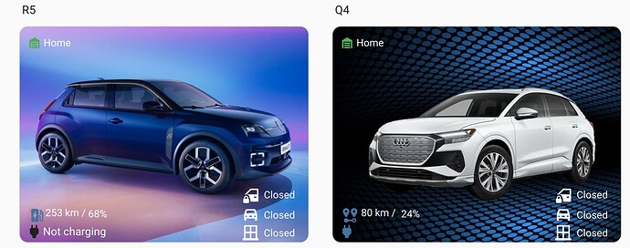

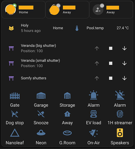

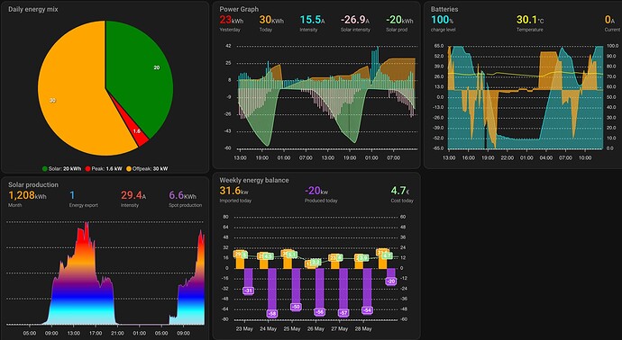

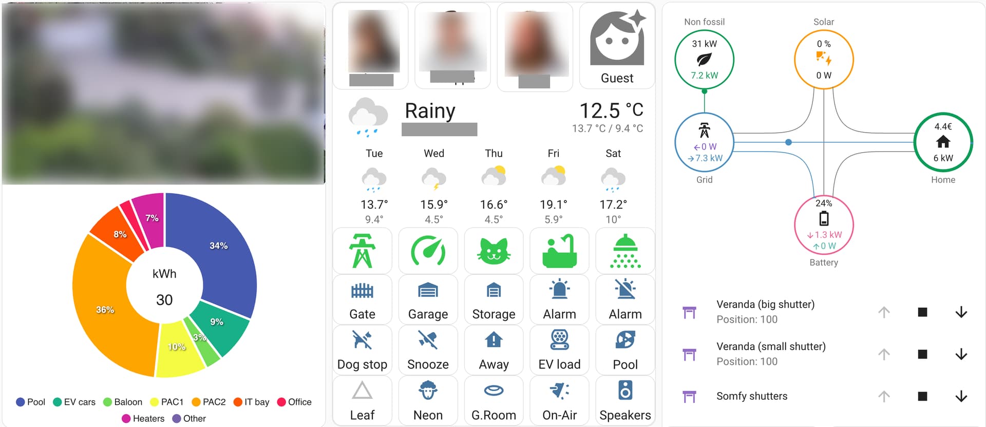

  1. Create a dashboard per use cases
    My dashboard for desktop is very different from the one for mobile. This is lighter and focuses on what I need to see/use when I'm on distance. The latter is lighter, compact, and simple. (you can assign a dashboard to each user on their device in the profile section and you can create new dashboards in the settings tab).
Mobile:
Desktop:

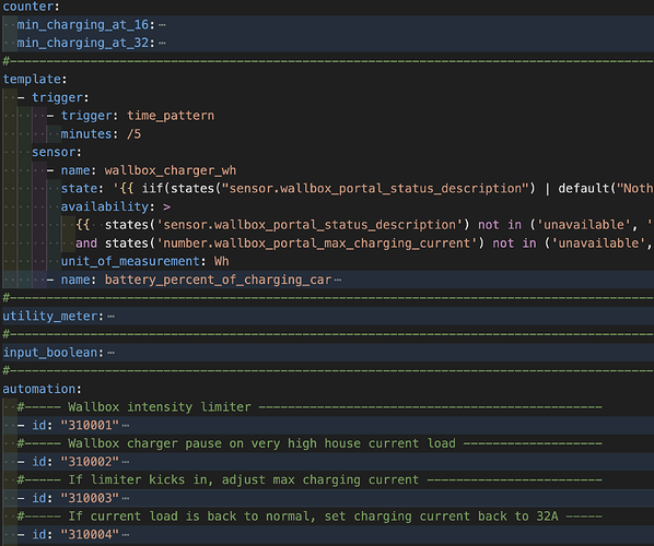

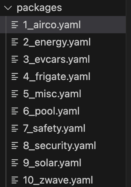

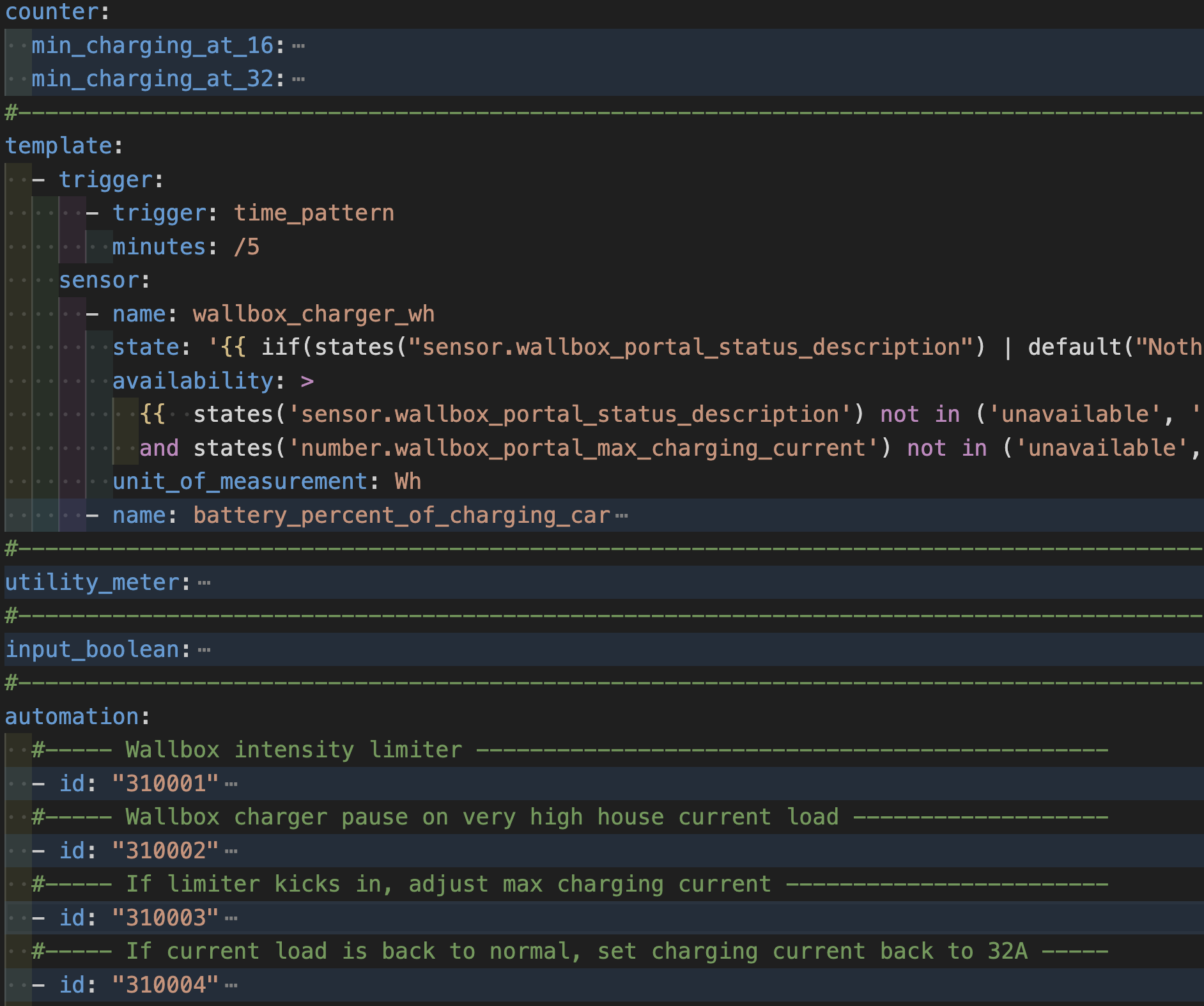

The "New" way (packages):
All switches, sensors, automation, scripts, etc. are now in the packages files nested in the "packages" directory, and it looks like this:
And one package file like this:

Some asked for the Apex chart code on the dashboard:
type: custom:apexcharts-card
chart_type: donut
update_interval: 10min
apex_config:
  dataLabels:
    enabled: true
    dropShadow:
      enabled: true
    formatter: |
      EVAL:function(value) {
        return value.toFixed(0) + " %";
  plotOptions:
    pie:
      customScale: 0.9
      donut:
        background: transparent
        labels:
          show: true
          total:
            show: true
            label: kWh
            formatter: |
              EVAL:function(w) {
                return Math.round(w.globals.seriesTotals.reduce((a, b) =>
                { return (a + b) } , 0)) }
header:
  show: false
  title: Daily energy used
  show_states: false
  colorize_states: true
series:
  - entity: sensor.daily_ev_charge_energy
    transform: return x/1000;
    color: green
    unit: kWh
    show:
      datalabels: percent
      legend_value: false
  - entity: sensor.daily_baloon_energy
    color: rgb(135, 221, 66)
    unit: kWh
    show:
      datalabels: percent
      legend_value: false
  - entity: sensor.daily_pac_consumption
    color: rgb(245, 221, 66)
    unit: kWh
    show:
      datalabels: percent
      legend_value: false
  - entity: sensor.daily_pac2_consumption
    color: orange
    unit: kWh
    show:
      datalabels: percent
      legend_value: false
  - entity: sensor.daily_it_bay
    color: rgb(255, 105, 0)
    unit: kWh
    show:
      datalabels: percent
      legend_value: false
  - entity: sensor.daily_heater_energy
    color: rgb(255, 0, 90)
    unit: kWh
    show:
      datalabels: percent
      legend_value: false
  - entity: sensor.daily_office_consumption
    color: rgb(169, 60, 244)
    unit: kWh
    show:
      datalabels: percent
      legend_value: false
  - entity: sensor.daily_pool_consumption
    color: rgb(70, 10, 186)
    unit: kWh
    show:
      datalabels: percent
      legend_value: false
  - entity: sensor.energy_various
    color: gray
    unit: kWh
    show:
      datalabels: percent
      legend_value: false
And as well for the Tesla style graph:
  - type: custom:tesla-style-solar-power-card
    house_icon: mdi:home
    battery_icon: mdi:battery
    generation_icon: mdi:solar-power-variant
    grid_icon: mdi:transmission-tower
    show_w_not_kw: 1
    grid_to_house_entity: sensor.teleinfo_power
    grid_extra_entity: sensor.teleinfo_periode_tarifaire
    house_extra_entity: sensor.daily_energy_cost_euro
    generation_extra_entity: sensor.solar_spot_percentage_tesla_graph
    generation_to_house_entity: sensor.solar_spot_production_watts_filtered
    appliance1_consumption_entity: sensor.wallbox_charger_wh
    battery_extra_entity: sensor.imeon_battery_charge
    generation_to_battery_entity: sensor.imeon_power_to_battery

I just wanted to add another possibility on your #14. You should really think about using packages. :smiley:
What you’re doing with directories and organization can be done much easier with packages. What you’re doing here, is dividing everything into files depending on the type, whereas packages are a more logical approach to divide things. Like into rooms or areas, or even with some specific things, like window covers.
The idea behind packages is the combination of all different things like sensors, groups, automations, scripts or whatever into one logical structured file. Let me give you an example: I’m using a few modes for our home, like “bed_mode” (when we are going to bed, turning this mode on turns off the lights, sets the blinds to specific positions, arm the alarm and so on) or “work_mode” (for the work-from-home office set the volume of the private telephone to 0, turn off the door bell while having a Zoom or Teams meeting…).
To make use of these modes, one needs a few helpers and automations:
As you can see, everything is in one shiny, nice place, ready to be maintained. In the end, there might be some more files with this way, but it is easier than working with a whole different files.
And one thing I like most about packages, you don’t need to setup the different integrations. Just set a sensor in a package file, and the sensor integration is called automatically.
If something new comes up in term of devices, you just need to add either a new file or put it in an already there package file. For example, I’m currently trying to build a new dashboard, and as it turns out, I needed an input_select to change the views. So it is just the creation of one file, “frontend_package.yml”, and in there are all the needed input helpers.
To be fair, packages are not the one-thing-fits-all approach, but they are worth mentioning, as they are a very underestimated and underrated component in HA.
