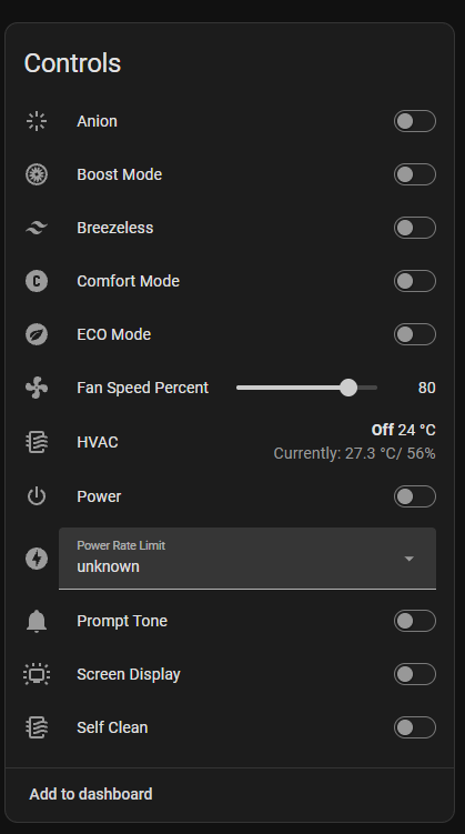

My setup
  • I use Daikin AC units (2 Air-Air heat pumps units, one for the night part one for the day part of the house, and 8 splits)
  • Most of them are Stylish units but some are older, I added external Wifi controllers to avoid any cloud dependance. You can unplug the native cloud-dependant Wifi chip, add an official Daikin wifi (ESP8266 btw) or the Faikin on the proper internal port.
  • They all are on my Wifi network (added through the Onecta app)
  • You need a robust Wifi network (I use Unifi APs)
  • I use Qubino Zwave electrical measurement devices, one per heat pump

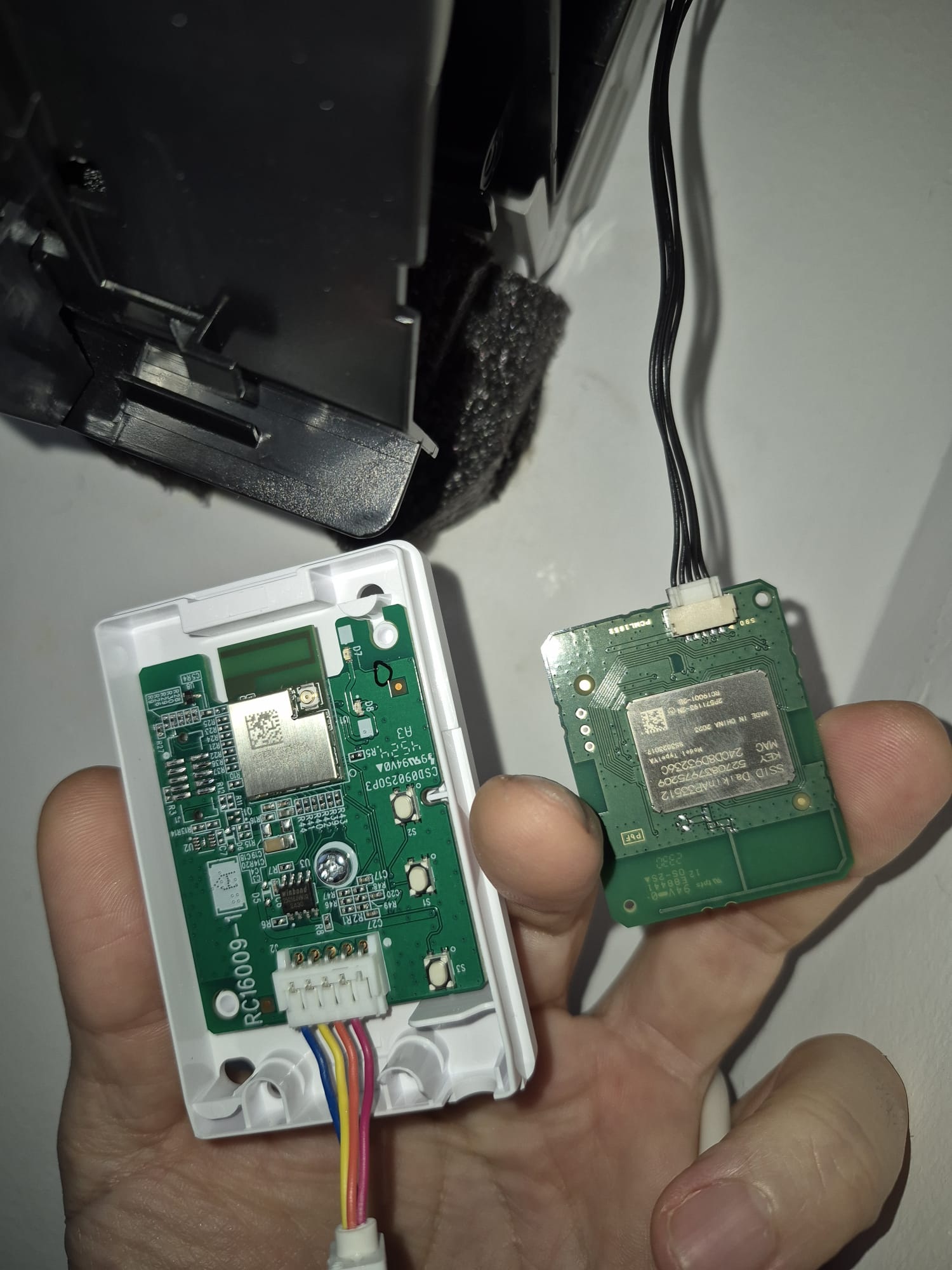

I kept the above mentioned automation but simplified the code accordingly.

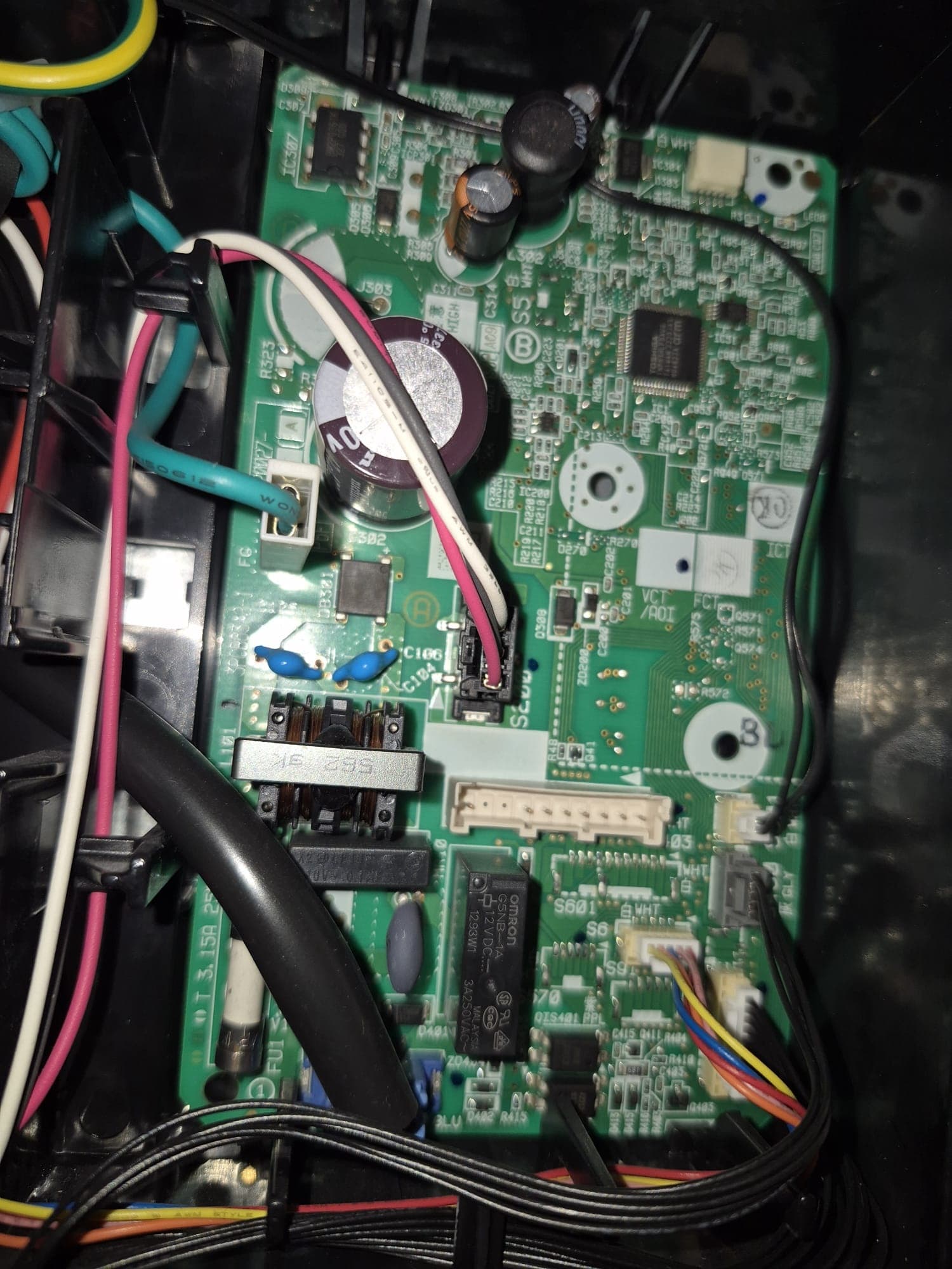

Do you happen to have any instructions or guide on how to put the Faikin in? I’m tempted to get them for mine due to how bad the built in temp sensor is but I’m unsure of where to start with taking it apart to get it in. I believe my unit - Daikin Vogue, is a very similar model to yours. Thanks
Sure. The github of Revk (faikout’s author) has it all. Compatibility list, cables, links to order, parts references. https://codeberg.org/RevK/ESP32-Faikout
Regarding your model yes it totally looks like my daikin stylish. It’s fairly simple to open. With current cut from the power:
A good video here.
Two little plastic tabs are hiding the screw on the lower part of the external plastic case. Remove them, unclip gently all around specificity on the top+back side you hear a little click.
Once done, locate on the right side of the appliance some metal box. Unscrew and there should be the control board inside.
At the top of it, there is a port named s21. It’s where the faiking goes. I ordered cables heads from aliexpress to make my own cables. (Sometimes there are inverted, it didn’t fry my faikin, just turn the plug upside down):
This in 4S and this if memory serves.
Just join them 1:1 pin-wise.
S21 is the white port at the top close to the blue one.
You can unplug the onboard pre installed wifi chipset from daikin if you don’t use the app. Cleaner wifi, better security. It’s the large square with a shiny center at the bottom of the picture.
Be gentle in plugin / unplugging your cable to the s21, it’s a bit fragile and can be ripped off if you force or forget their is a little lock at the bottom of your cable plug. Don’t ask me how I know.
If all goes well your faikin will blink blue and offer a wifi hotspot.
If you use my automation remember to disable the faikin auto mode switch (cool/heat) in its settings.

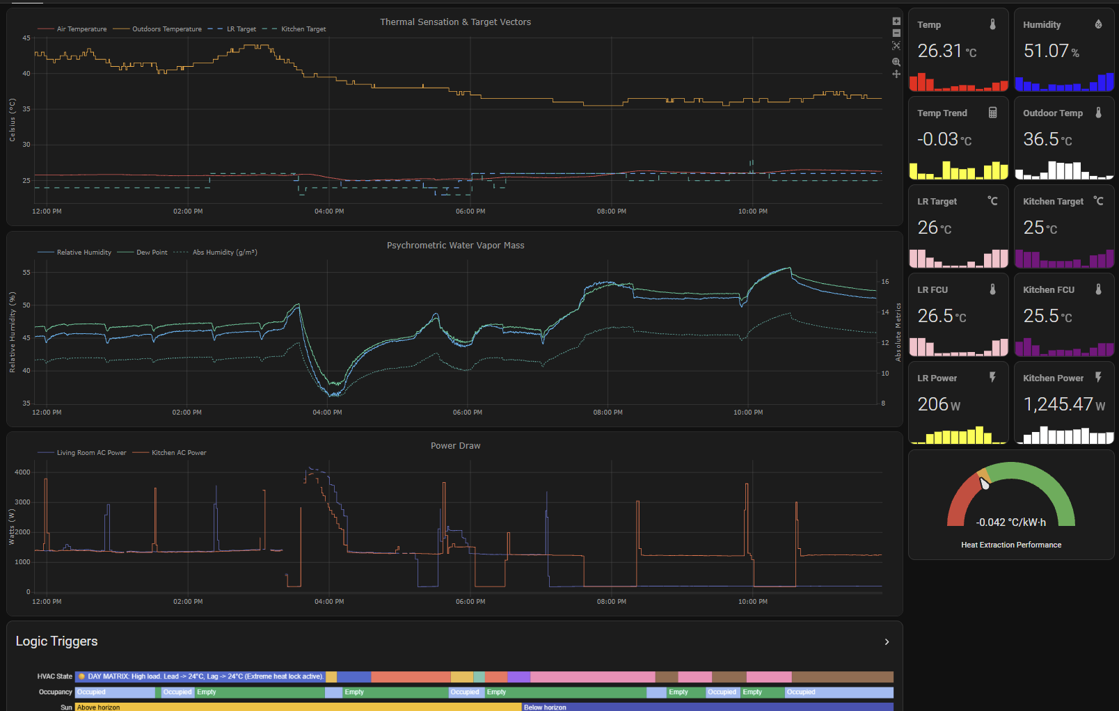

I love what you’ve done and I’m sure you’re still improving upon it.
I’ve done a pretty similar thing, except that my goals, constrains, and equipment are different.
First of all, no two spaces in my house shares an HVAC unit. So, I have full independence setting up each unit however I want. My main area of concern is the ground floor, which is a full open-plan area with two ducted Midea units, 4 and 5 tonne respectively.
They are inverter (multi-stage) units, which makes manipulating their operation a whole different game.
Also, the two HVACs don’t know the place is cooled and heated by two HVACs. What follows is that, if left to their devices, one of them could stop the other from working if it gets to work and overcool the place first. The automation orchestrates their operation so that they work in tandem.
Bear in mind that two units working at 1500 watts is a lot more efficient than one operating at 3000 watts. It’s more cooling for the same money.
My goals were:
  1. To maintain a super stable, narrow temperature range of 24-24.8 °C at day. At night, I think it’s 25-25.5 24-24.8 °C while the place is occupied. If unoccupied, it sets them both to 27.
  2. To prevent them from ever pulling more than 1500 watts each at any moment. If allowed to operate at capacity, they pull up to 5000 watts each. I learnt that it is vital not to change the set point by more than 1 degree at a time so that the compressors don’t panic and go into full speed. One hour at full speed costs the same as 4 hours at low speed.
  3. I’ve learnt that no one ever needs to set them any lower than 23 or higher than 26 for any reason.
  4. I use an external Apollo Air-1 to measure temperature and humidity. However, just like you, I do not use the raw temperature reading. I rather calculate the real feel of the home.
  5. I follow a lead/lag regiment to equalize their wear and tear.
  6. The automation minimizes thermal shock by preventing the units from starting at full speed, which is their default action. It does that by setting the target temp the same as the current temperature at the beginning. After that, the automation works as described above.
  7. The automation keeps an eye on humidity too.
  8. Failsafe: If the Apollo Air-1 goes missing, it sets both HVACs to 24.
  9. Sets fan speed to high when place is occupied, and auto when not.
  10. Just like you, I got the automation to log the reasoning behind every change it makes.
    My units aren’t as problematic as the Daikins you have. And they provide incredible information in their entities.
Have a look here:
