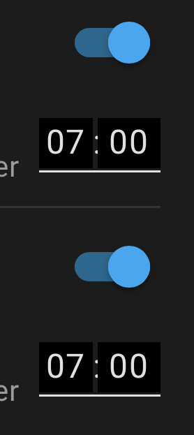

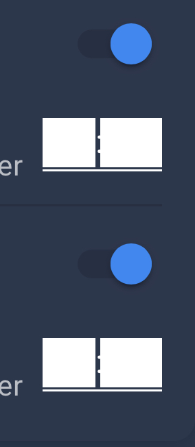

Starting with iOS 15.1 and iPadOS15.1 the INPUT background color behaves different as before.
![IMG_6083](https://user-images.githubusercontent.com/22775515/139800746-f6f527d5-2c38-4dd8-8c5b-ea278ce4b4e8.jpg)
But even with ```paper-input-container-shared-input-style_-_background``` set in the skin it is now displayed wrong and you have still a white box and now a radius.
![IMG_6084](https://user-images.githubusercontent.com/22775515/139800861-58f186d4-7a45-4875-9b73-f9adae205b73.jpg)

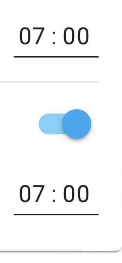

If you use default it is only by chance o.k.
![IMG_6081](https://user-images.githubusercontent.com/22775515/139801016-185f49c0-febc-4477-911e-3a5de1b5e295.jpg)

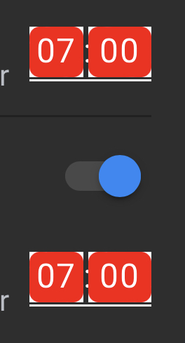

But in dark mode, it is already starting to get weird.
![IMG_6082](https://user-images.githubusercontent.com/22775515/139801058-576294dc-02c5-4d76-9f8a-37d00715b4a2.jpg)
It seems that the standard transparent is now white.
And yes, you can directly say: Go to the theme author. But as this is in every (dark) theme and in dark mode standard and even additional tweaks as above are only the half way, I think it should be fixed here.

Perhaps it is not a bug, but due to changes in webkit, you cannot use dark custom themes anymore without frontend corrections/adoptions. If you know a way to use a dark custom theme with input fields, I’m interested in the solution as well.
Would appreciate it.
For the second: The problem is there. Newest devices, newest iOS. Every device I have tested. Even if you don’t have the problem, it is there. For ages.

To make it more crisp. Set only a theme with
ha-card-background: '#2E2E2E'
and nothing more. Only the above. And give me a hint, how to set the white on these input buttons to another color, which works for Safari.
Because outside of Safari/Webkit the white is not there
