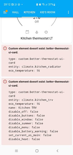

Since last update all climate and thermostat cards(even not customized) are missing more info dialog commands and info from the three dots menu…
I can’t make restore, because of 2FA changed(the only last way is to reinstall everything from scratch but it will be a loooong week). Can I do something to fix this error?
Thank’s for your support.

From what I’ve heard, a custom card on your system is causing the issue. I’ll try and get more details.
Here is the issue Error message: "Failed to call service system_log/write. unknown error" after update 2023.9.2 Ā· Issue #17954 Ā· home-assistant/frontend Ā· GitHub
Are you using Better Thermostat? If yes, uninstall that.
reinstall with v1.1.1 fix it

Definitely Custom better thermostat was the problem. Now more info dialog with commands on normal thermostat cards are working on Android application.
I am still on charge but after half hour will try on Mozilla at home.
P.S. Tested on Mozilla Firefox (mobile and desktop versions)
And the cards are working.
Presets aren’t the right ones…:
Bur at least are working
And that’s after removing from HACS
1.Better thermostat integration
and
2.Custom better thermostat lovelace card
