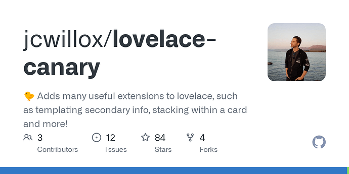

I donāt know if it works with HA 2024.3, but did you already checked Canary?
Heard about Canary.
Not ready to jump to Canary yet.

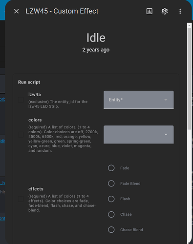

I just experienced the same issue. Think I know a cause.
Thereās a bug with scripts (Iāve noticed this bug going back several months now) that seems to be affecting this. When I created a script, it automatically assigned it a name script.1709853343256
. I renamed this to script.message_control
and that is reflected in the entitiesā settings screen, but when I go to the dev tools it still shows script.1709853343256
as the entity when I type message_control
(even after clearing browser cache; I believe script.1709853343256
persists in the scripts.yaml even though the UI shows script.message_control
When I open the more-info for script.message_control
there are no fields showing (but they do show in the dev tools).
If I rename the script back to script.1709853343256
and open the more-info, now I can see the fields.

This is my scripts.yaml:
'1709853343256':
alias: message_control
fields:
message:
selector:
text:
multiline: true
description: The message to broadcast
required: true
sequence:
- service: tts.speak
message: '{{ message }}'
(yes, Iām aware the service call would fail, itās just proof of concept)
The issue is that the 1709853343256
in scripts.yaml
doesnāt change whether the entity is changed from script.1709853343256
in the UI entity info/settings dialog. And the fields
donāt show up in the more-info if the UI entity ID doesnāt match the scripts.yaml
entity
Interesting find. Iāve definitely experienced issues in the past with scripts that were secretly still named with a randomly assigned number. Iāll bet thatās whatās happening. Are you able to modify the scripts yaml file to fix it?
Changing the 1709853343256 in scripts.yaml
to message_control
(and reloading scripts configuration) if youāve previously renamed the entity ID in the UI resulted in script.message_control_2
. The original script.message_control
āis no longer being provided by the script integrationā, so delete it, then remove the _2
from the other active entity ID in the UI, flush browser cache and now the more-info fields should appear.
