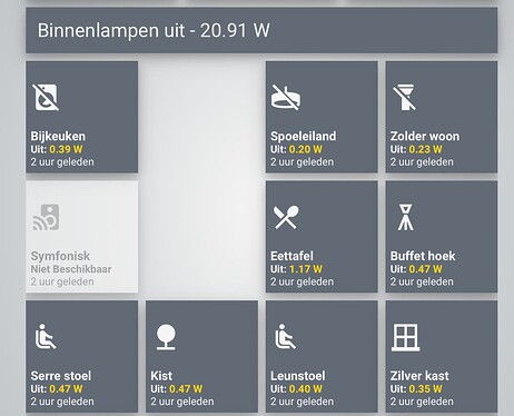

this would be just like any other card everywhere in HA.
dont use a title (should be a new option for that), and use a custom card (button-card stands out) and give that a template to display atop of the section.
use those allover, and, given they use javascript can be very useful in showing browser related details.
browser_mod might come in handy as that provides several useful templating options in Jinja, so maybe use a small markdown card in that case
hereâs a grid as example using button-card templates:
btw, in next release we can have unnamed sections:
and (in yaml) include those buttons easy-peasy
