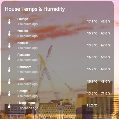

It’s not a templated entity, and when clicking on it from this dashboard card:
So how do I then get it to show how it should? (and used to before the 2025.7 HA update)
What card type is it?
It’s a combo of stuff:
type: entities
entities:
  - entity: sensor.lounge_multisensor_air_temperature
    type: custom:multiple-entity-row
    secondary_info: last-changed
    entities:
      - entity: sensor.lounge_multisensor_humidity
    show_state: false
  - entity: sensor.ensuite_ms6_air_temperature
    entities:
      - entity: sensor.ensuite_ms6_humidity
    show_state: false
  - entity: sensor.kitchen_ms6_air_temperature
    entities:
      - entity: sensor.kitchen_ms6_humidity
    show_state: false
  - entity: sensor.passage_ms6_south_air_temperature
    entities:
      - entity: sensor.passage_ms6_south_humidity
    show_state: false
  - entity: sensor.bathroom_ms6_air_temperature
    entities:
      - entity: sensor.bathroom_ms6_humidity
    show_state: false
  - entity: sensor.gym_multisensor_air_temperature
    entities:
      - entity: sensor.gym_multisensor_humidity
    show_state: false
  - entity: sensor.garage_multisensor_air_temperature_2
    entities:
      - entity: sensor.garage_multisensor_humidity_2
    show_state: false
  - entity: sensor.nspanel2_temperature
    entities:
      - entity: input_text.text
        styles:
          width: 43px
          text-align: right
    show_state: false
title: House Temps & Humidity
show_header_toggle: false

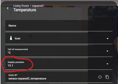

The one showing crazy is the:
There’s a workaround here:
Annoying that this has become an issue that needs fixing on a per-card basis…
at least this was an easy fix… for one dashboard at a time.

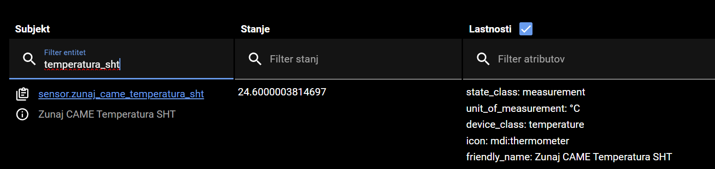

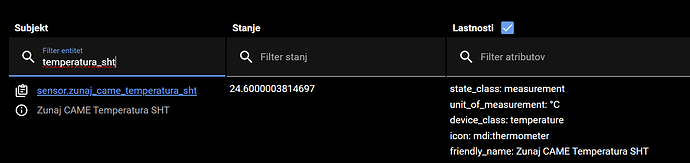

Nope… esphome says: “sending state 24.6000 °C with 1 decimals of accuray”
while in developer tools i get this:
God only knows where HA got that “3814697” :rofl:

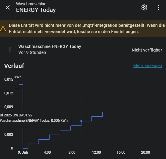

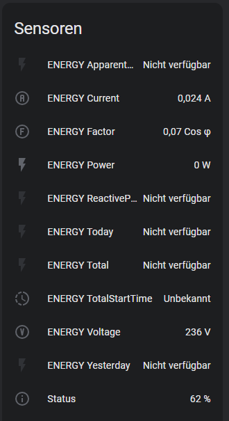

I updated to version 2025.7.1 today (from 2025.6.3) and since then all Tasmota smart sockets are missing numerous energy consumption entities. It’s the same entities that are always missing. The data is still available via MQTT Explorer. It is solely due to HA or the MQTT integration.
Message says: “This entity is no longer provided by the “mqtt” integration. If the entity is no longer used, delete it in the settings.”
Any ideas on how to get the entities active again?
