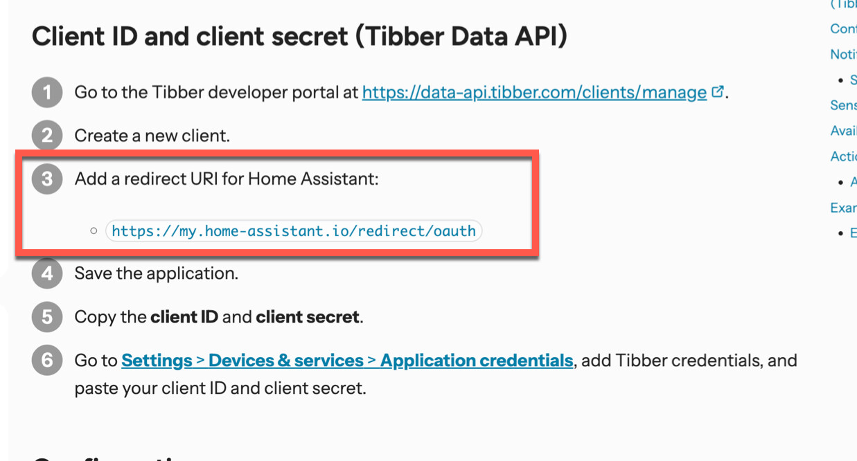

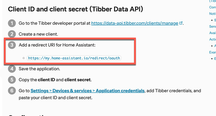

Can you please shed a bit more light on this part?
When I have no nabu casa cloud account, how is that URL crafted?
Thank you!
