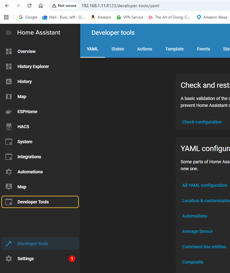

I believe you can get the same functionality by doing this in configuration.yaml but it’s another set of hoops to jump thru just to get back to the exact same functionality as we had before:
panel_custom:
  - name: Developer Tools
    sidebar_title: Developer Tools
    sidebar_icon: mdi:application-cog-outline
    js_url: /api/hassio/app/entrypoint.js
    url_path: developer-tools/yaml
    embed_iframe: true
    require_admin: true
    config:
      ingress: core_configurator
I’m not on 2026.2 yet but I tested it on 2026.1 and it works as expected:
You can change the icon to the original by swapping this:
sidebar_icon: mdi:hammer
