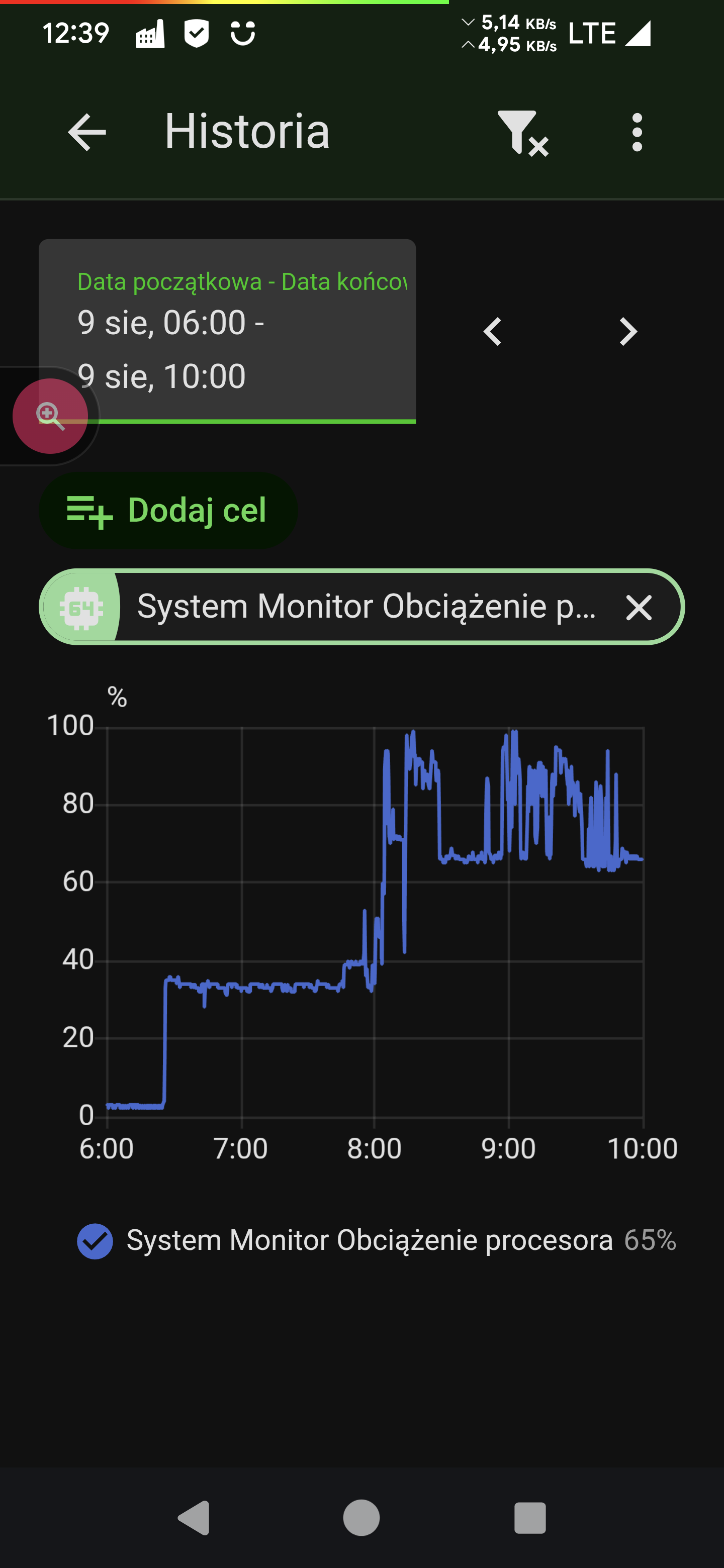

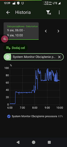

Hello.
After update from 2026.7.4 to 2026.8.1, I have problem too, CPU usage and temperature.
Was spook creating your repairs or was it the repair for template helpers?
