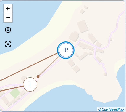

Must vary a lot by region. I am currently on a small island in the middle of the southern ocean. The map shows buildings and roads.

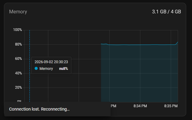

Having the same issue but not on Proxmox. On HAOS native on a intel nuc.
HA is crashing for me as well. I can ssh into my server, but HA UI is not available.

HAOS rebooting after a couple minutes on boot. Run on a HA Blue.
Rebooted in safe mode and Restored the last backup and am up again. Waiting to see if there are any others having issue with this release.
Same here. Hubitat borked, rolled back to 2026.8.3 and everything works again. Will make sure to check the comments before upgrading next time.
