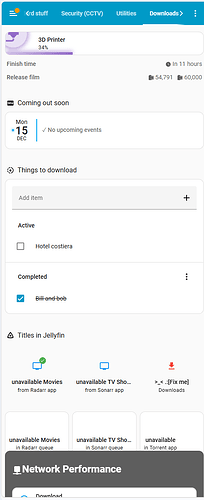

  • Nerd Labs: 3D Printer, Jellyfin, Unifi system monitoring and HA system monitoring

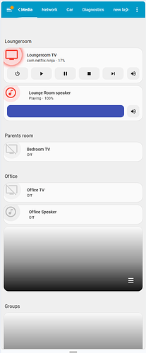

  • Media: Android TV, Google Home Speakers

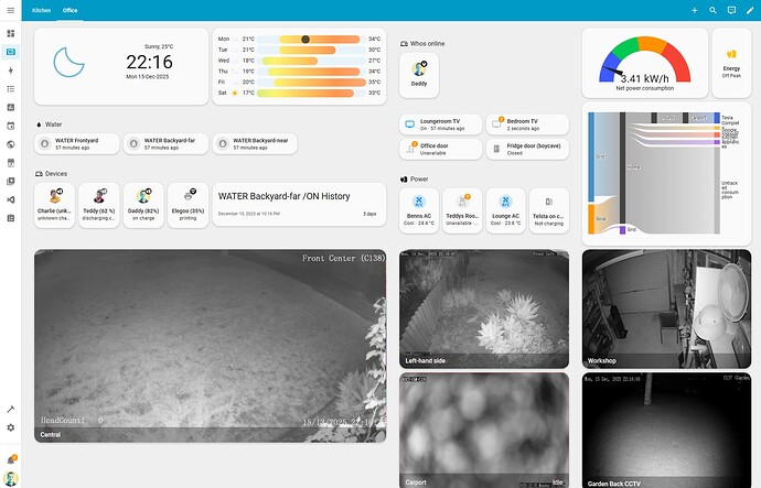

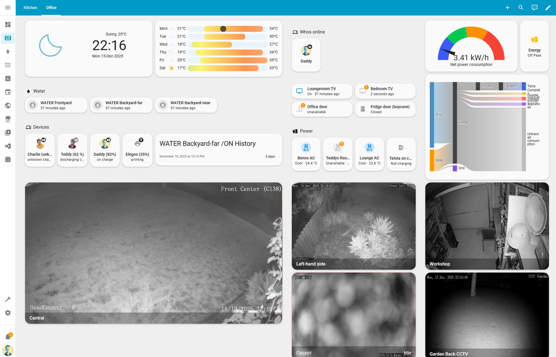

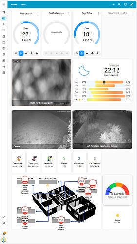

Dashboards for 27" 1K landscape display in kitchen
Dashboards for 40" 4K TV/horizontal display in Office

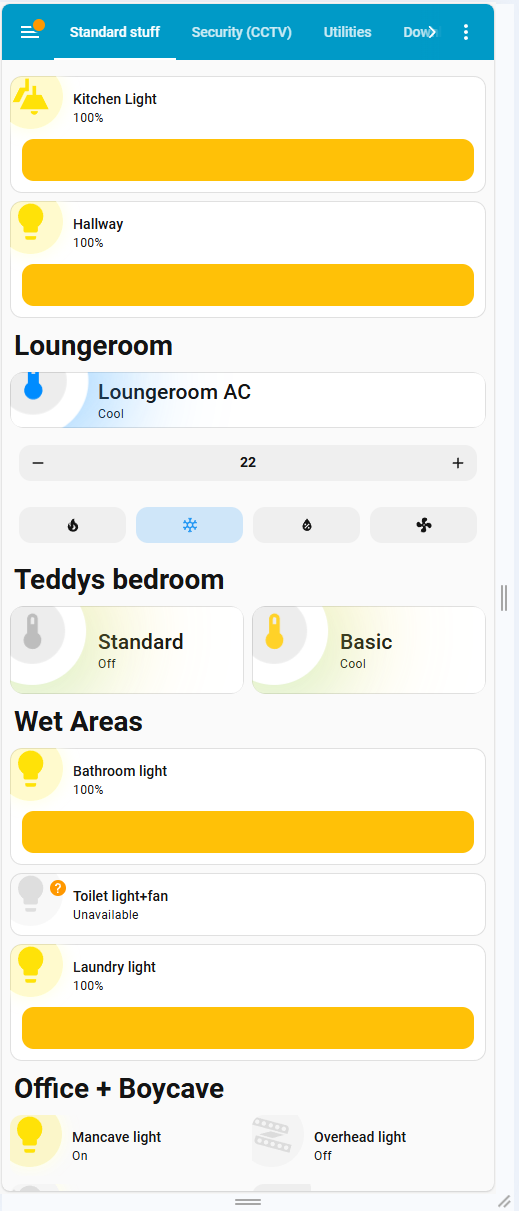

The standard stuff is using a design combination of mushroom cards, mushroom themes and card mods. Which are all from the HACS store using some very customer CSS from Anas Box.
Here' his YouTube video, this contains all the reference material you will need to get started.

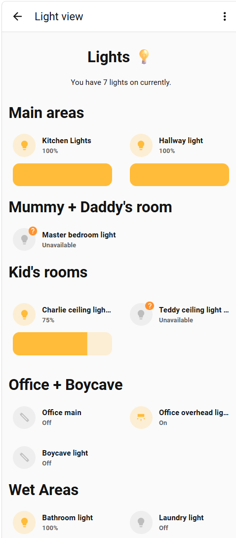

Lights are typically Philips Hue E27 bulbs. While I am not a fan of Hue as I find they are rather dim as an actual light. Saying that I have installed and removed Tuya equivalent Wi-Fi bulbs and Shelly 1L relays, due to the stability of Hue's bulbs and locally controlled ZigBee bridge.
Original 1-page:
Simplified single page to copy Google Home Layout. While this worked, I found the page was a bit too busy, trying to do too many functions.

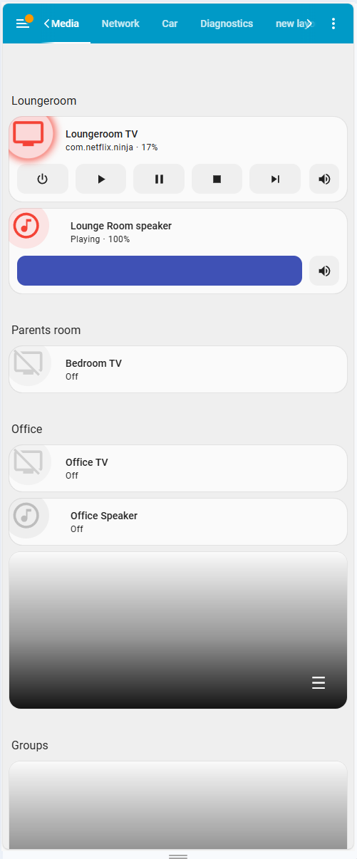

Modular 3-pages:
As I found myself looking for a single function, I split this to be consistent with my other dashboards into a Lights and Climate function.
![image|220x500] (upload://ApCqP4poL3KWeKNzW6WbBZNVGr2.png)

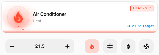

Thermostat cards
These are really cool, with animations and nested sensors.
These are a grid card of a custom button card and a second grid with 2x mushroom-climate-card
Heat
Cool
Dry
Fan
Off

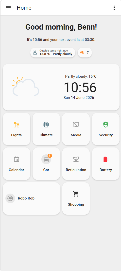

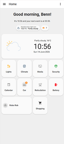

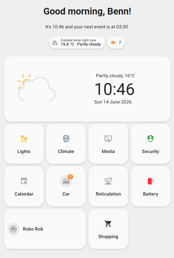

Home Page
Header using Markdown card + grouped badges (not 100% in love with the badges)
{% set time = now().hour %}
{% if time >= 5 and time < 12 %}
  {% set greeting = 'Good morning' %}
{% elif time >= 12 and time < 17 %}
  {% set greeting = 'Good afternoon' %}
{% elif time >= 17 and time < 24 %}
  {% set greeting = 'Good evening' %}
{% elif time >= 0 and time < 5 %}
  {% set greeting = 'You should be sleeping' %}
{% endif %}
{% if state_attr('calendar.family', 'start_time') == None %}
  {% set cal_message = "you have no upcoming events, enjoy 🥳"%}
{% else %}
  {% set start_time = state_attr('calendar.family', 'start_time') | as_timestamp | timestamp_custom("%H:%M", false) %}
  {% set cal_message = "your next event is at " + start_time %}
{% endif %}
# {{greeting}}, {{user}}!
It's {{now().hour}}:{{now().minute}} and {{cal_message}}.

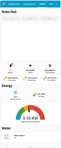

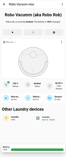

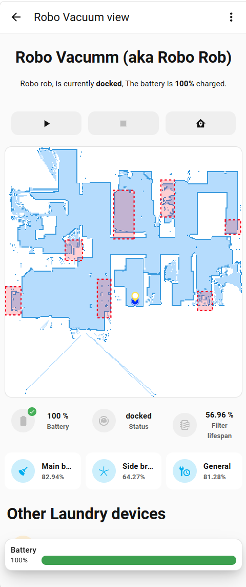

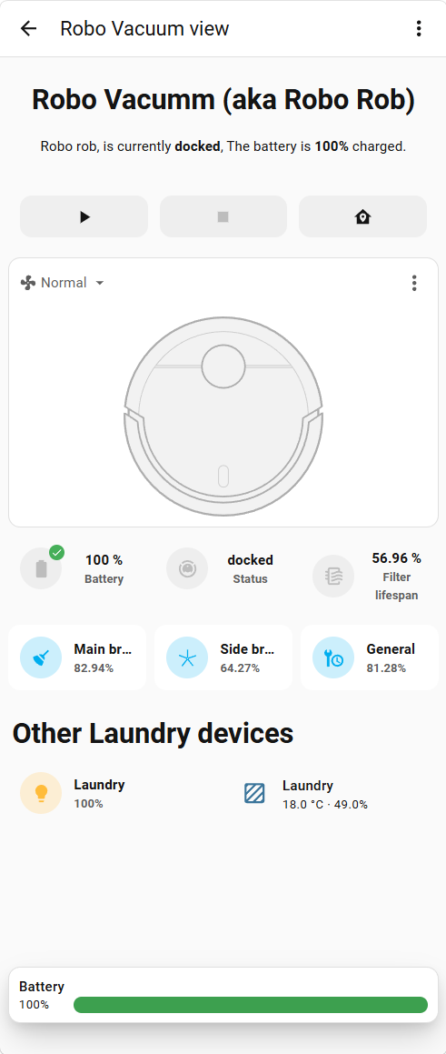

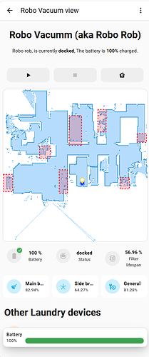

Vacuum view
Docked/cleaning/returning
Error (so I can go looking for where it got stuck)
Header
Code
# Robo Vacumm (aka Robo Rob)
Robo rob,  is currently **{{ states('vacuum.robo_rob') }}**, {% if is_state('sensor.laundry_vac_robo_rob_battery', 'unavailable') %}
  >_< Oh no im lost can you find me?
  {% else %} The battery is **{{ states('sensor.laundry_vac_robo_rob_battery') }}%** charged.
  {% endif %}
Footer
Code
type: custom:entity-progress-card
entity: sensor.laundry_vac_robo_rob_battery
min_value: 0
bar_size: large
theme: optimal_when_high
layout: horizontal
tap_action:
  action: none
hold_action:
  action: none
double_tap_action:
  action: none
icon_tap_action:
  action: none
icon_hold_action:
  action: none
icon_double_tap_action:
  action: none
max_value: 100
hide:
  - icon
grid_options:
  columns: full
Navigation
Code
type: custom:mushroom-vacuum-card
entity: vacuum.robo_rob
commands:
  - start_pause
  - return_home
  - stop
primary_info: none
icon_animation: false
icon_type: none
fill_container: false
grid_options:
  columns: 12
  rows: 1
layout: vertical
secondary_info: none
card_mod:
  style: |
    ha-card {
      background: transparent !important;
      border: none !important;
      box-shadow: none !important;
      text-align: center !important;

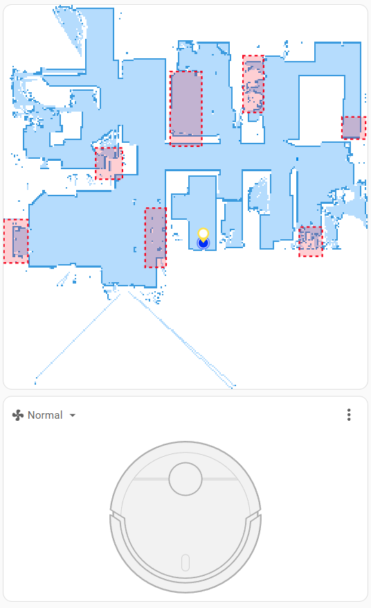

Picture/vacuum card
Maintenance stack of cards
Code
square: false
type: grid
cards:
  - square: false
    type: grid
    cards:
        icon: mdi:battery
        tap_action:
          action: perform-action
          perform_action: unifi.reconnect_client
          target: {}
            device_id: 8ebe2713a594ad1a63c617f19bf603f6
        hold_action:
          action: none
        double_tap_action:
          action: none
        secondary: Battery
        primary: >-
          >_<
          {% else %}
            {{ states('sensor.laundry_vac_robo_rob_battery') }} %
          {% endif %}
        features_position: bottom
        multiline_secondary: true
        color: black
        vertical: true
        icon_tap_action:
          action: none
        badge_icon: >-
            mdi:close-thick
          {% else %}
            mdi:check
          {% endif %}
        badge_color: >-
            red
          {% else %}
            green
          {% endif %}
        card_mod:
          style: |
            ha-card {
            mushroom-state-info$: |
              .container {
                font-size: clamp(16px, 2.5vw, 20px) !important;
                font-weight: 700 !important;
                color: white !important;
                text-shadow: 0 0 10px rgba(255, 255, 255, 0.3) !important;
        icon: mdi:robot-vacuum
        tap_action:
          perform_action: vacuum.return_to_base
          target: {}
        hold_action:
          action: none
        double_tap_action:
          action: none
        secondary: Status
        primary: "{{ states('vacuum.robo_rob') }}"
        color: black
        vertical: true
        icon_tap_action:
          action: none
        card_mod:
          style: |
            ha-card {
              .container {
        icon: mdi:air-filter
        tap_action:
          action: none
        hold_action:
          action: none
        double_tap_action:
          action: none
        secondary: Filter lifespan
        primary: "{{ states('sensor.laundry_vac_robo_rob_filter_lifespan') }} %"
        color: black
        vertical: true
        icon_tap_action:
          action: none
        entity: sensor.laundry_vac_robo_rob_filter_lifespan
        card_mod:
          style: |
            ha-card {
              .container {
  - square: false
    type: grid
    cards:
      - type: custom:mushroom-entity-card
        entity: sensor.laundry_vac_robo_rob_main_brush_lifespan
        secondary_info: state
        icon_type: icon
        tap_action:
          action: none
        hold_action:
          action: none
        double_tap_action:
          action: none
        icon_color: light-blue
        icon: mdi:broom
        card_mod:
          style: |
            ha-card {
              box-shadow: none;
              border: none;
        entity: sensor.laundry_vac_robo_rob_side_brush_lifespan
        icon_type: icon
        tap_action:
          action: none
        hold_action:
          action: none
        double_tap_action:
          action: none
        icon: phu:vac_sbrush
        card_mod:
          style: |
            ha-card {
              box-shadow: none;
              border: none;
        entity: sensor.laundry_vac_robo_rob_unit_care_lifespan
        icon_type: icon
        tap_action:
          action: none
        hold_action:
          perform_action: ""
        double_tap_action:
          action: none
        icon: mdi:wrench-clock
        card_mod:
          style: |
            ha-card {
              box-shadow: none;
              border: none;
columns: 1

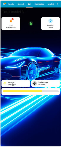

The car was another one that I moved towards a monochrome style.
Original
When i changed car's from a blue to a boring white unit, I matched style

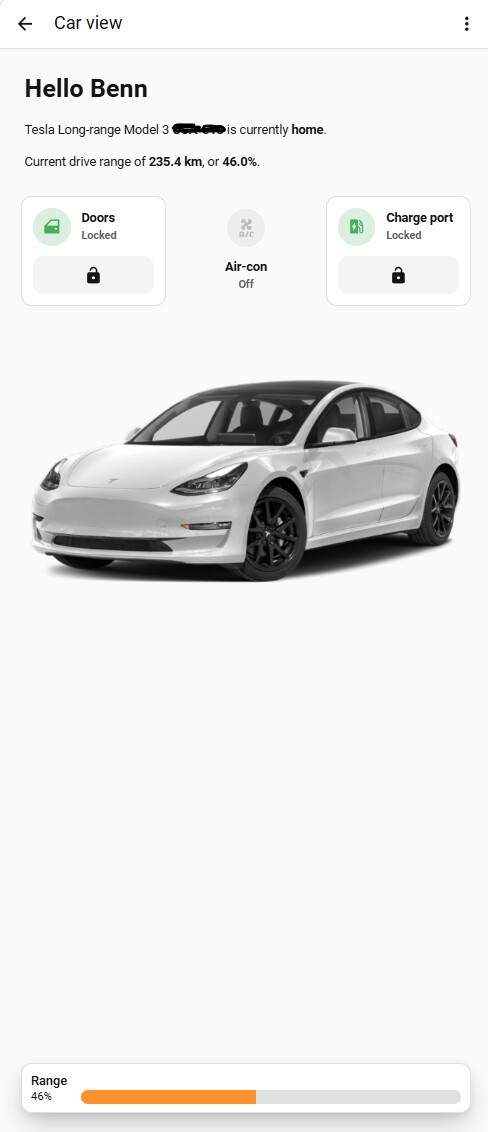

Header
Code
# Hello {{ user }}
Tesla Long-range Model 3 **xxx xxx** is currently **{{ states('device_tracker.tesla_model_3_location_tracker') }}**.
Current drive range of **{{ states('sensor.tesla_model_3_range')|float|round(1) }} km**, or **{{ states('sensor.tesla_model_3_battery')|float|round(1) }}%**.
Footer
Body
[details="Summary"]
entity: sensor.tesla_model_3_battery
min_value: 0
bar_size: large
layout: horizontal
tap_action:
action: none
hold_action:
action: none
double_tap_action:
action: none
icon_tap_action:
action: none
icon_hold_action:
action: none
action: none
max_value: 100
hide:
  • icon
    attribute: raw_soc
    grid_options:
    columns: full
[/details]
[details="Code"]
type: vertical-stack
cards:
  • square: false
    type: grid
    cards:
    • type: custom:mushroom-lock-card
      entity: lock.tesla_model_3_doors
      tap_action:
      action: toggle
      icon: mdi:car-door
      grid_options:
      columns: 4
      rows: auto
    • type: custom:mushroom-entity-card
      entity: climate.tesla_model_3_hvac_climate_system
      icon: mdi:air-conditioner
      layout: vertical
      tap_action:
      action: more-info
      hold_action:
      action: more-info
      double_tap_action:
      action: none
      icon_type: icon
      fill_container: true
      card_mod:
      style: |
      ha-card {
      grid_options:
      columns: 4
      rows: auto
      tap_action:
      action: toggle
      icon: mdi:ev-station
      entity: lock.tesla_model_3_charge_port_latch
      grid_options:
      columns: 4
      rows: auto
  • type: picture
    image:
    media_content_id: media-source://image_upload/a3dec4d7c3508d4afa1618d102222eba
    media_content_type: image/png
    metadata:
    title: tesla-2022-white.png
    thumbnail: /api/image/serve/a3dec4d7c3508d4afa1618d102222eba/256x256
    media_class: image
    children_media_class: null
    navigateIds:
    - media_content_type: app
    tap_action:
    action: none
    card_mod:
    style: |
    ha-card {
[/details]
