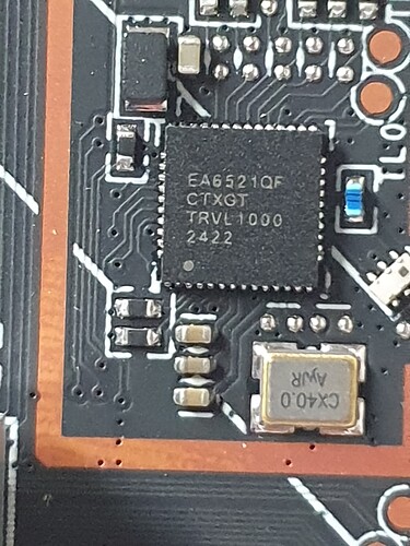

Now I wanted to see if I could possibly get Wi-Fi working.
The chip is a Seekwave EA6521QF.
I saw in another forum that someone had compiled a 32-bit driver.
Is it possible to compile it for 64-bit, but I have no idea how.
Thanks in advance
Interesting to know that other box works with the same firmware. Does it have 1G ethernet or 100M like mine ?
About wifi, i’m not interested in making it works + i probably have a different wifi chip on my box.
Sorry but you’re alone for this.
