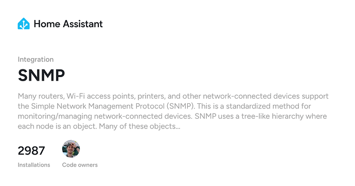

You can also configure power sensors alongside energy sensors in the Energy dashboard. Power inputs accept sensors with state_class: measurement and appropriate units (for example W or kW ).
This includes how to add the state_class

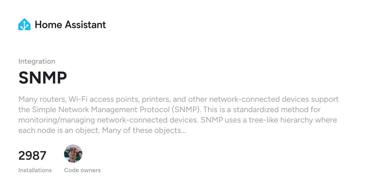

This is the post that helped me figure out adding an APC NMC via SNMP.
Seems to have everything but the Wh that I’m trying to read from mine. I’d already got both into HA using the NUT method, but that doesnt give me my energy consumption either unfortunately.
